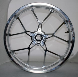

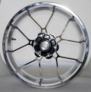

RE: Rear wheel spacers
11/16/10 9:26 AM
Just put my new wheels on
* Last updated by: DogoZX on 11/16/2010 @ 9:26 AM *
11/16/10 10:23 AM
Just put my new wheels on....
Don't I wish! Sorry for the false alarm. Same old stock wheels. Just some new tires. BT-003s. Can't wait to give them a good try but I'll have to wait for next Spring--------unless we get a few nice, warm days before winter really sets in----I might be tempted.
11/16/10 10:41 AM
No worries... I got yer back...
