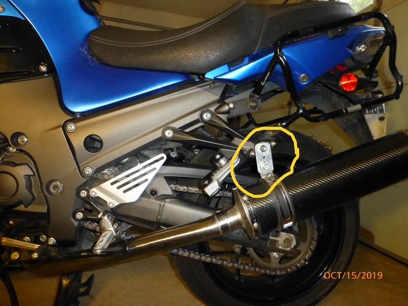

Because in 2012 Kawasaki made the mufflers larger in diameter, most side racks said they only worked for model years 2006-11. I added a 2" strap and dropped my mufflers for clearance. If you replace the stock mufflers (smaller in diameter) you do not need the straps.
