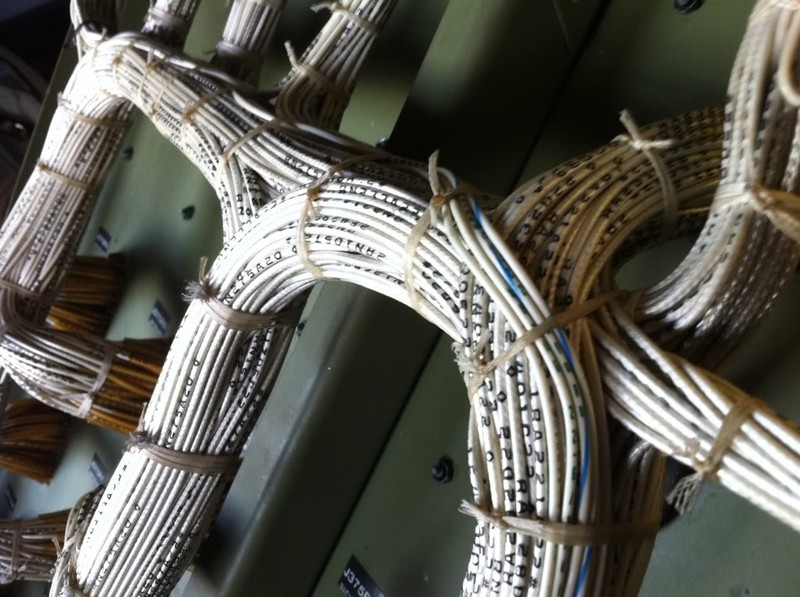

Thats why we use a nylon string to tie aircraft harnesses. The tie wraps will cut the wires with enough vibration.

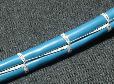

Old school waxed twine lacing works well.

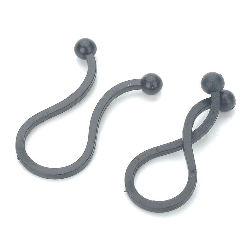

I have also used these.
If I use regular tie wraps, I try to put the wires in split loom first.
