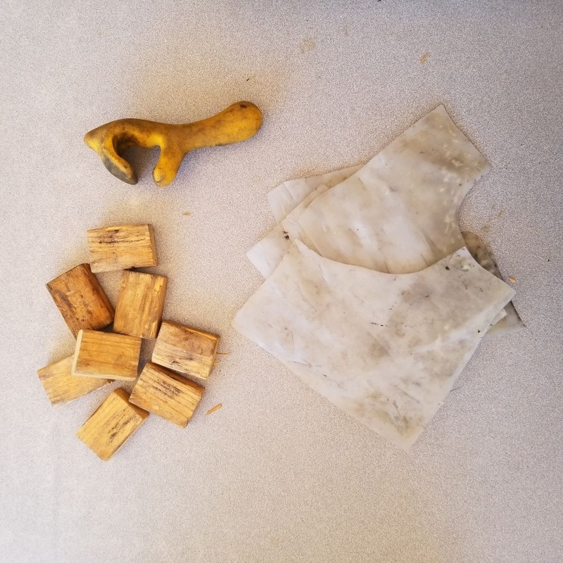

The plastic from the cat food containers works really good, tough and pretty thin. The set below probably 12+ tire changes and still in good shape. You might need to buy a cat.
The "yellow thing" tire tool is awesome, it's a must have.
When changing wide, low profile rear tires, it can be hard to keep your knees pushing the bead to the center
of the rim. Using a furring board cut into small blocks you can push down on tire and put the small blocks
between tire and rim to hold the bead down.

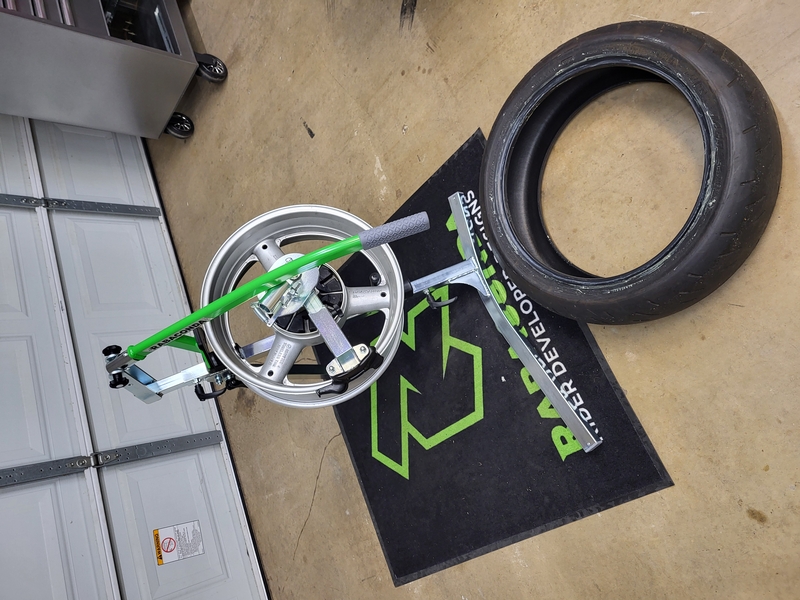

That Rabaconda is very cool. Looks nicer then the No-Mar

Several years back, I was just about to spring for a set of BST Rapid TEKs for the busa. A tire changing plan was a must. I looked into the Cycle Hill tire changers thoroughly and the No-Mar bar and Yellow Thing seemed to be the most useful tools.
One fault of the Cycle Hill No-Mar tire changing systems is that they're not free standing. You need to bolt them down to something, preferably a garage floor. That's a little invasive for how often I change tires. There is a trailer hitch attachment so you can fasten the tire changer to your pickup for stability. Goes to show, it's not as simple as spinning the bar around the rim. I'm sure it still requires a lot of force.
There's a respected member on hayabusa.org who raved about the Rabaconda but now he's not recommending it. He didn't elaborate on why. Looks like you insert a bar and turn the bead pusher around the rim, similar to the No-Mar bar.

The specs look the same but this is a 'stand up' vs 'pancake'? Does this have
advantages over the pancake?

I use a vice on a bench to break the bead off the rim. I use 3 spoons, a 25gal barrel with a cut hose going around the open part, plus it's more a trash can when rims are not laid done on it> Dish soap not watered down, but hand applied. If I were stronger, I wouldn't have used a cutter for the rear tire. Front was a snap.
Nephew came over with his old 16" HD tires and unloaded the second one off the rim faster. Go figure.
I use touchup paint for the dings on the rims. Can't see if from afar anyway. Home he dunt kneed no raba trickshit.
I have a balancer going way back. Maybe a 2gal air tank with enough pressure to pop them on the bead.
With a new one sided razor, cut it from the top or bottom. Put it back together and bring it to a tire changing place. They have plenty of those for metric cars. That, or go to a car dealer like Honda and match the bodies.
Shop manuals are very limited in scope. A mechanic should already know how to tear down and assemble any bike. The manual is more for torque and spec settings. Maybe for specific parts hidden places. Thus the renderings or photos.
