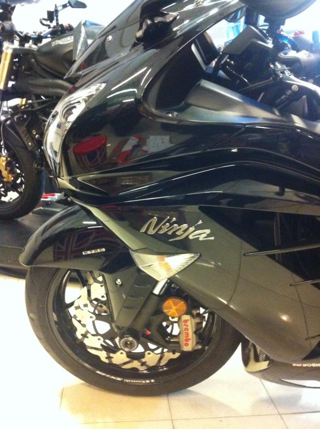

OK so rotors and front caliper in but couldn't fit the rear rotor as it wasn't the correct one even though the catalog says so, asking galfer for assistance in problem. Been raining for the last few days so haven't had the chance to test this upgrade but itching like hell for a ride. Pix from the garage, looks pretty doesn't it???

That is a purdy looking rotor there, Coxyboy.

Nice Hardware you got there!

Wow, looks lean and mean. She just pops!
Rock on!

Dats a bad boy Coxy and thanks for the report!
