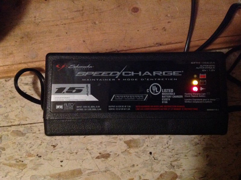

My bikes (4) up here in Canada go through a 5-6 month winter storage! Trickle chargers are great! I attach a lead to each battery and snake it through for easy access and leave it there year round. You can buy extra leads from yuasa. Some have inline fuses attached. My charger came with one sae connector and another with alligator clips see pics. I just got mine from walmart 40 bucks. Check your owners manual mine had a couple of recommendations for chargers. One time during riding season I had left the key on overnight on my old zx 600 with one of the old style batteries you can add water to, it was completely dead, some cells needed topping up with distilled water, threw it on the trickle charger overnight and it was resurrected from the dead! Still using it. When you have $400-500 in batteries a $40 buck charger is worth it. Battery Tender and Yuasa make popular chargers can't tell you which one is best. I rotate my charger from bike to bike every few days or week to week during the storage season. BTW, all my bikes started with no battery issues this season! Just a slow start to the riding season this year. It snowed today!
