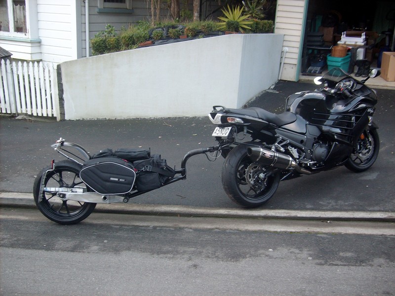

At some stage going to trial at the flying quarters. Stable at speed and encourages some nice wheelies with traction control off.

Make one guys
Its a modified bmx frame, motorcross swingarm, Teflon bushes, led lights, scooter shock, switchboard waterproof jack plug, ducati fibre front mudguard, zx14 generation1 front wheel and a quad bike universal joint as coupling. The most expensive bit was the wheel and only because there isn't many zx14s being wrecked in New Zealand so parts are expensive. Its all just second hand parts found on trademe other than lights. Trademe is a bit like ebay but local to New Zealand.
Whole thing cost about 600usd plus bags. Easy build. Could make one in a day once you have the parts. Cheaper than a givi pannier set up for a zx14r.

I wonder if...you could mount a seat on that bad boy...;)Tighten up yer rear suspension some...
