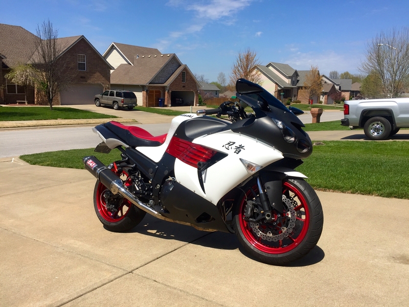

Damage update. The lower triple clamp appears to be bent. Replacement forks were not parallel and would not line up with the upper triple. I should have a replacement lower triple today or tomorrow. I had hope to have back on the road yesterday, but now it maybe mid week or next weekend. I had planned on going to Austin for the MotoGP this coming weekend, but now I am unsure

RE: Crashed her!
04/09/16 2:41 PM
Back on the road, I still have plenty of things to improve, but at least i can ride her again.

RE: Crashed her!
04/09/16 4:51 PM
WOW, nice job on the repair!
New BBW '14 14R
RE: Crashed her!
04/09/16 5:49 PM
Nice! Great paint scheme especially like the wheels and seat. Just the right balance and proportion of colors.
