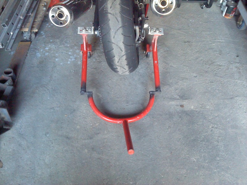

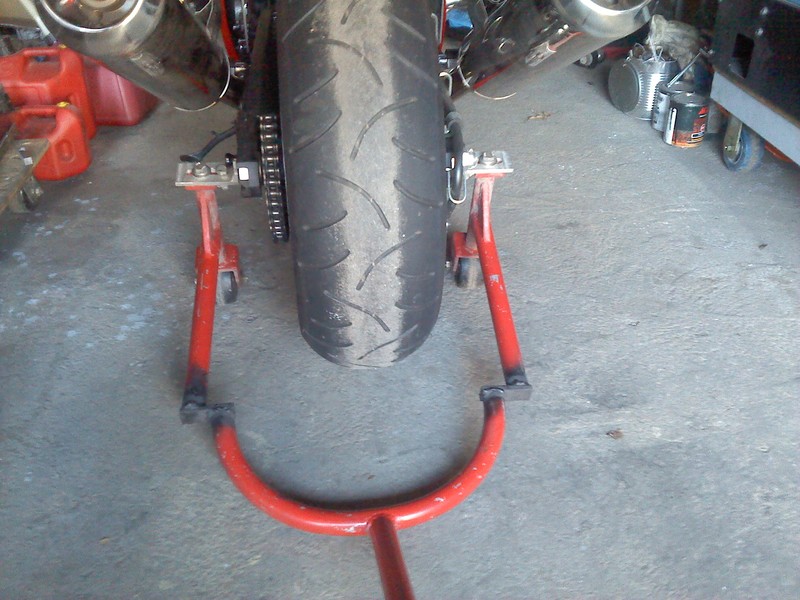

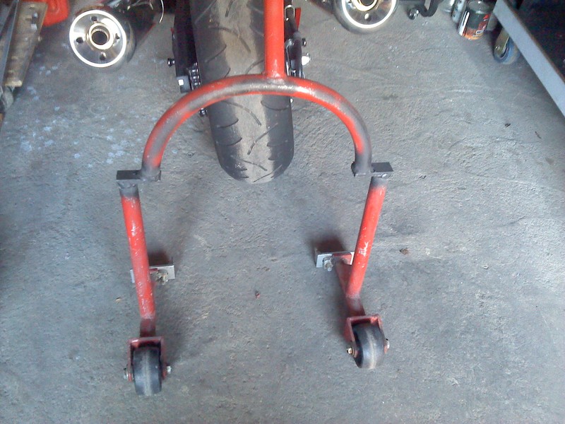

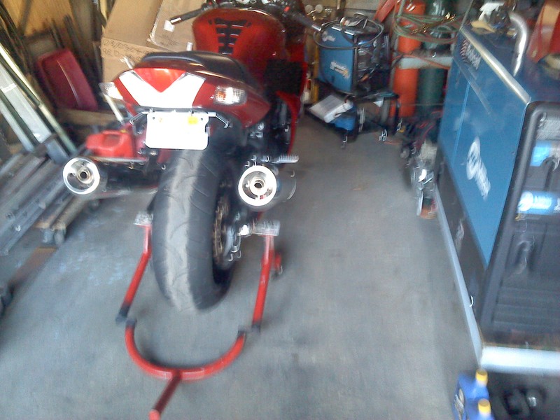

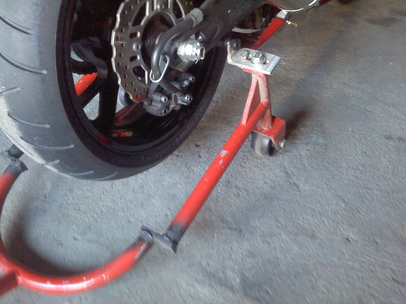

Well Mad...depends on what type of rear stand you're describing...I know...Pit Bull.I have one.Mine's a forward facing rear stand....lift arm on the left side.I would think the rear forks of the stand would probably be the same?Regardless of where the handle is at?I will take pic of mine right now...and show you how I had to manipulate the lifting blocks and fork positions to get it to slide in under the frame and onto the spools.Here ya go....Taken from over the seat and down before doing the full lift.Note the position(s) of the lift blocks and forks.You see that last pic there...notice the 'block' length has been cut down.That's on the right hand side.With the rear facing handle,you don't need to be concerned about the handle hitting the body like you do on my stand...so you can get the rear wheel probably more 'in the center' between the two forks.I couldn't,not with that handle having to be pushed down past the left side of the bike to make the lift.So I compromised and got as close to center as I could.
Mine clears the caliper and rim okay...BUT...with mine,I HAVE to lift the handle AND at the same time as soon as the rear wheel begins to contact the ground,I have to quickly 'turn" the handle(and stand) to the left,and slide out from under the rear frame there at the same time.If I just lower it straight down...the lift forks will get hung up under the belly pan at the rear there...and damage that....so for me it's a 'lower,twist,pull" deal as the bike is settling onto the sidestand.
I think you can tell there that the blocks are actually NOT the way the instructions show how to set it up.That damage was from way before.The muffler scrape wasn't from the stand hitting it.But you can see the black plastic lower fairing tip has been scraped(in the top pic)....it will if you try to go 'slow' with this particular deal.
I had to cut that one length of block off the right one there cause it will catch on the rim...only once for me...until I figured out what was actually hanging up.

With my rear handle Pit Bull I can't get near the spools at all. The stand arm hits the brake banjo bolt on the rear caliper way before the stand cups get near the spools. I tried every way I could to get it to work, no dice.

Do you see how I've got my 'blocks' turned the other way.The instructions show the blocks going in the other way,with the stand arms on the outside.That will not work in my experience with it.One has to be on the outside,the other on the inside...and you can see there that the wheel itself will not be at dead center on the stand when lifted.It will be over to one side some,but not anything to fear about a tipover...it won't be that far out.IF I had the lift handle at the rear...the adjustments might be different,IDK.Those spools need to be out about an inch at least from the underside of the swingarm...as mentioned.Not sure where I got mine.Sorry.

Grn, looks to me like I have my spool fork attached so that the slot bracket sticks outward on both sides. Yours are attached so that the slot bracket points inward on the right and that is why it was hitting your rim and caliper. I can see why you did that though. The high side of the fork is to the rear on both sides of your setup. That seems as though that would be designed to lift and hold the spools more safely than the low side. I think what PB did was send you a stand with two right forks. Mine have the high side of the fork to the rear too but I can have the slot to the outside on both sides so it clears everything.
I think PB should sen you a lefty fork free of charge. You got to righties with your'n.
Oh well, mystery solved. It's workin for ya so keep it or change it sup to you

I tried to have mine fit like yours...when I first got it.I had the blocks set up like yours as well...I don't know WHY though that it somehow didn't work right...but it didn't.The block(s) just wouldn't move far enough over somehow to get the distance that you have on there.I never measured the width...but I will.Thanks.I ran out of groove for the block bolts on there.Maybe I just 'didn't get it' when I first assembled it.That could be.But right now...how it is...it's fine for lifting...the dimensions of the new bike are actually the same as far as width and hieght and all.I've been lifting my new bike several times now....she IS a tad heavier...so that feels a bit different,pushing that handle down.
I couldn't use mine without cutting the end off the handle and using an extension in there.The leverage was just not enough to feel comfortable lining up,looking over,and reaching down for the handle.The extension really solved all that...made everything much easier to do.I can look over the seat,line er up,begin the lift and continue lifting without any drama with mine like it is.Like you said...once she's cradled in the forks,it's all the way then.And yeah,I did turn those forks around.Seemed to me looking at it that the 'other way' was kinda chancy considering the way the swingarm was angled and all.So mine probably isn't set like the instructions...but it has worked fine for 4 years now.
I did notice now that ya mention it...the fork height.I've got mine all the way down...for the same reason you installed those bolts on there.That MAY be why the deal was hitting with my blocks the way they are now.IDK.I'm not gonna change it now..It works okay.

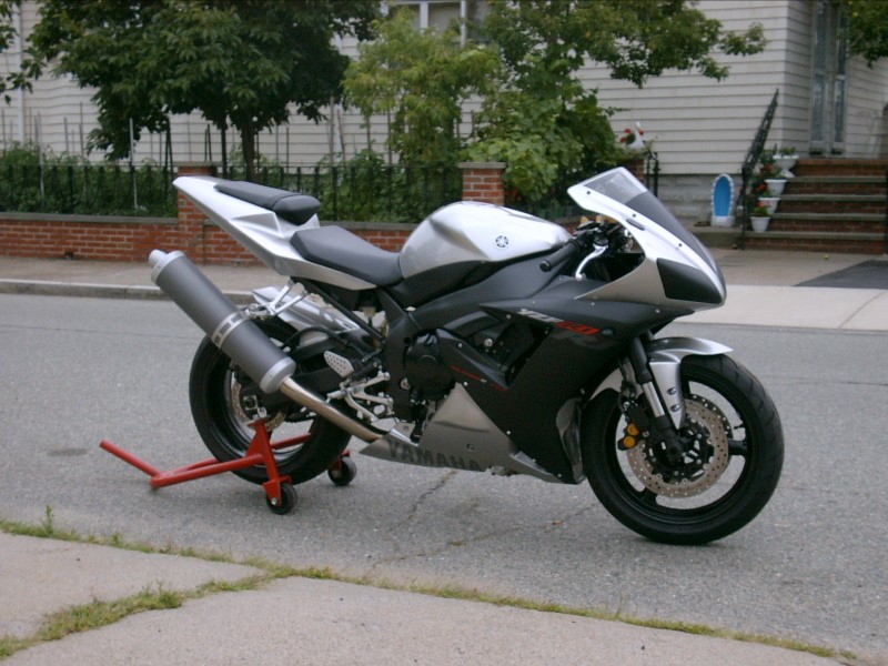

Hey Bean, I have a home made stand that mimicks the pitbull rear stand. It worked well on my R1 but was`nt wide enough for my 14. I ended up cutting it and extending it out using 3/8" plate 1-1/4" x 3" scrap I had laying around. It now works perfectly and didnt cost anything but some time. Hope the pic`s help.
(I know the handle is crooked it`s been that was since 2001 when I made the stand in hurry).

SORRY Maddevill, I just noticed I thought this was Beans thread!!! I saw the RED bike and was reading another thread Bean was doing on trailer chocks and... you can figure it out I GOT SO CONFUSED!
