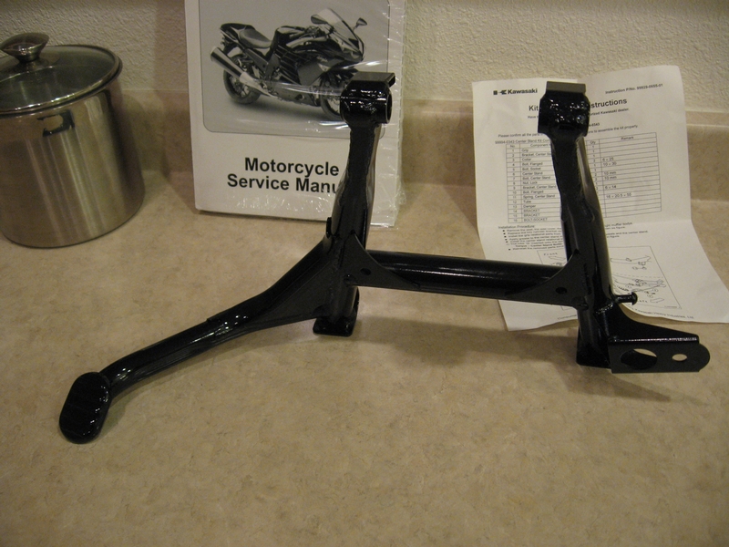

Considering 'now' how a 'center stand' attaches
to the 14's I think I've sorted this whole thing
out;
Since I don't actually want a permanently
mounted Center Stand, I can buy one anyway
and just push the two bolts through the
mounting holes, loosely turn the nuts on the ends,
nix any spring action, and wham, I have a
'center lift'
Don't laugh, I think it could work.

I've had the centerstand on all 4 of my 14's for chain lubing and tire changing. I have a bike rack, back wheel is easy and then for the front, I strap the rear, lift the front so it just turns the front wheel, and change the front tire that way.
Need to remove a muffler to install the pivot bolts so you have to deal with that each time you temp the centerstand if going that route.
I tag a foot before I tag a scrapper pin at the foot pegs. Bike is way too heavy to dance the Marquez at 60°... LOL
Right, that's pretty tight right there,
I might look into cutting the 'socket' end
off of a shoulder bolt and see if I can slide it
in there, of course there's still my
permanent mount option.
