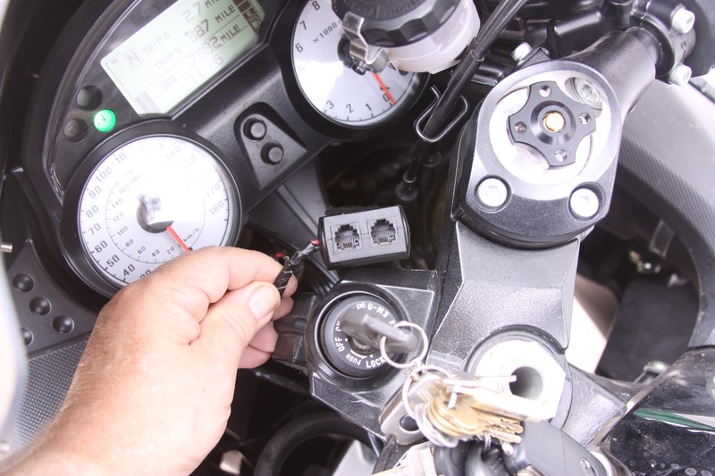

I bought a used zx14 and it has a after market part I can't figure out. It is Velcroed to the ignition switch housing it has two ports that look like ether phone or cat5 cable connection it appears that it only has two wires connected to it one to ground one to the power. Does anyone have any ideas, I have looked on the net for any thing like it or might connect to it. All help will be appreciated it is driving me nuts.( Didn't have far to go)

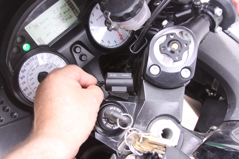

Here are some pictures, I don't know if the words on the side are going to be readable but one says main the other is accessory. alg8er do you know what types of devices use this hook up. Grn14 they made it easier to load a pic now, I read about it in this forum in the last sticky. This is a good thing for me because I have tried on other forums and couldn't figure it out. Again thanks for any help.
PS I went to the dealer I bought the bike from He thought it was an auxiliary power port like alg8er suggested, but I still haven't found anything on the net that looks like it might hook up to it. [url=]Your text to link here...[/url]

Never seen any type of accessory that uses that style plug. Most heated gear uses a coax (or similar) style plug. With all the common plug types available (Powerlet, cigarette style, SAE, coax), makes you wonder why they went with that style.

What's it say on there?Those definitely look like phone jacks...but why they'd have phone jacks on there?A 'landline'?...IDK...never seen anything like that.Some sort of line(s) for a headphone?IDK.Plug a landline phone in there...see what it does?

Often what people use is terms of parts and hardware is a reflection of their job/experience/environment rather than industry practice or standard. A telephone jack is common and inexpensive to acquire. The original owner probably had good access to this type of product and felt comfortable working with it. It would not be my first choice for a motorcycle application (extremely low current, not very weather or corrosion resistant). But for charging a Cel phone, or powering a GDP it probably got the guy by. Investigating the quality and integrity of the wiring job (gauge, route, and source connection point) and if it appears sound..... replace the Tel jacks with a more suitable connector. It is always nice to have some power up front.
As for the writing Grn14 , it looks like it says "Main Line" & "Accessory" (which does sound like telephone terminology).

Thank everyone for their input. Hi audioboyz they are phone jack type, spyglass I think you might be right as after looking at it closer it doesn't look like an after market product I mean the wires coming from the connector is wrapped in electrical tape all the way to the ground and power wire. I think I am going to remove it as I have no use for it and the glue on the velcro isn't working well here in the 107+ heat.

Looks like phone jacks to me. Appears that there are 4 pins in each side, that would make each side capable of two telephone lines each (1 line on the middle two pins and a second line on the two outer pins). Another indication that it is a phone jack is the labeling "main line" (telephone lines in) & "accessory" (for an answering machine or fax machine). If you take it apart you should find that the pins are strapped together from one jack to another. The wire feeding it appears too big for the jacks. It would be interesting to see how it's connected. I think it's the previous owners rig job. I vote for removing it completely.
