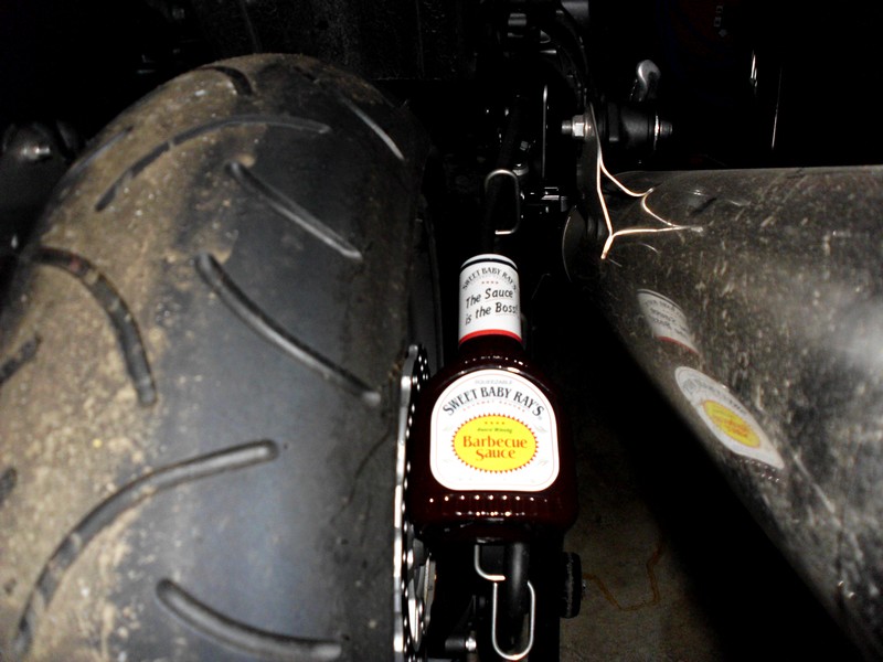

I got over 8K on the stockers. Can't say I recommend it but it is possible. Prolly should have been changed at 6K which is til 2x as many miles as most get out of a tire on their 14. This tire is offering about 0 insurance in the wet/dusty riding conditions dept. + riding on ~1/8 rubber in the center. I stuck my hand inside after tire was removed and felt the thickness and trust me, when it gets down this far it is about 1/8 inch.
The ware bars are the small transverse bits of raised rubber down within the tread lines. You can see them pretty clear in this pic. Supposed to be time to switch when the tires ware down enough that the ware bars are touching the pavement. The center tread often gets worn more than the outlying tread where the ware bars are located. Mine is about bald on center here and big ol' chicken strips on the sides.
* Last updated by: Rook on 3/7/2011 @ 2:43 PM *
