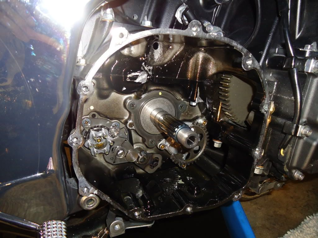

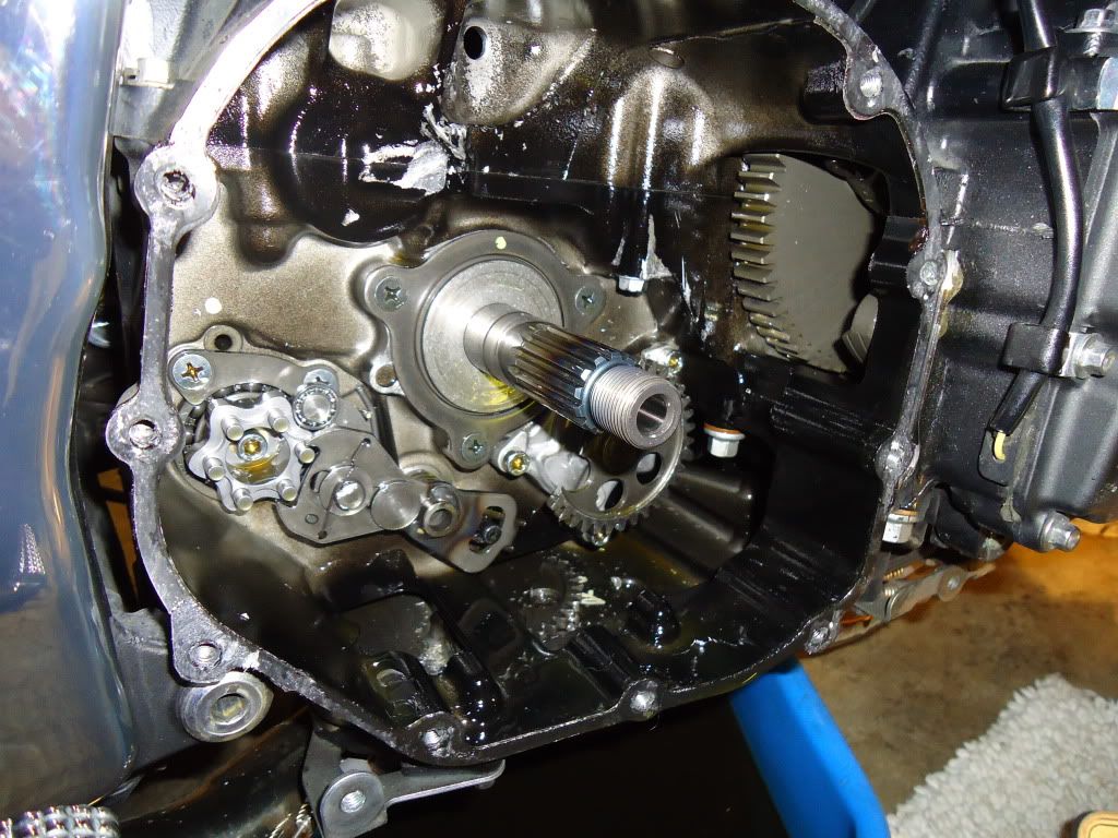

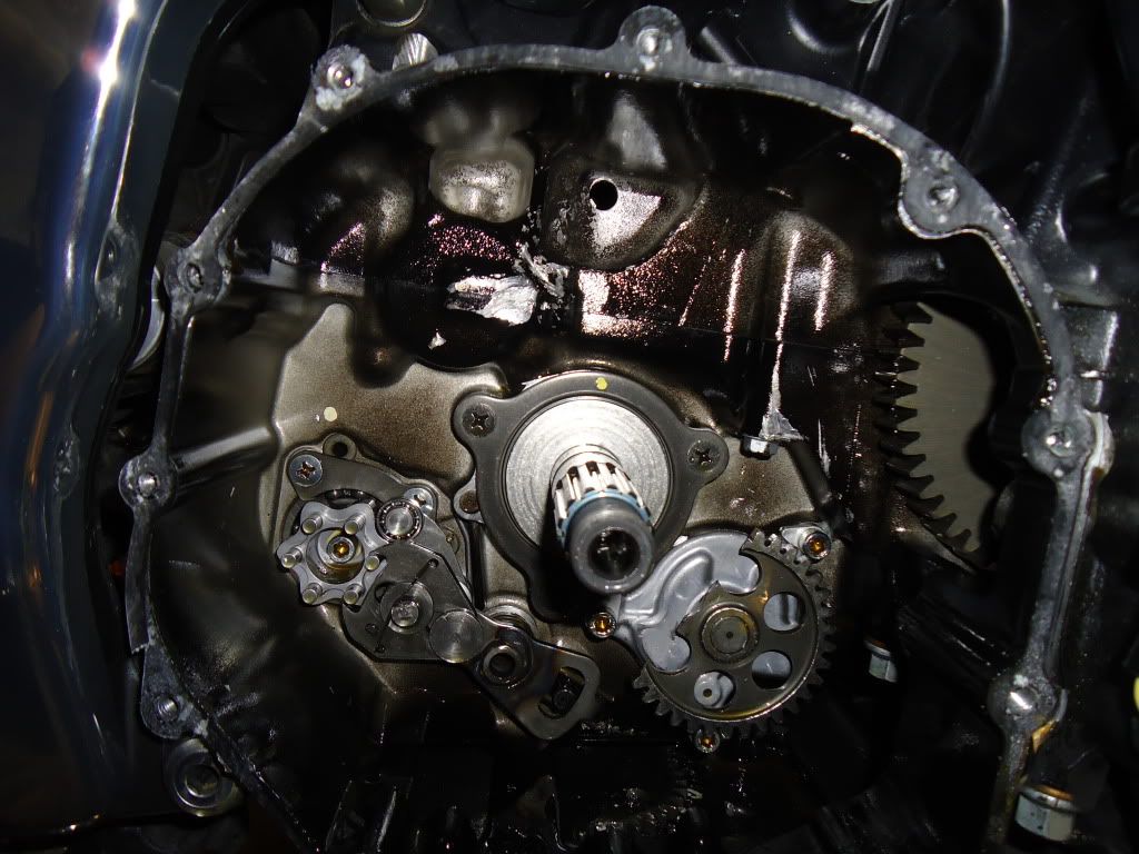

o far:

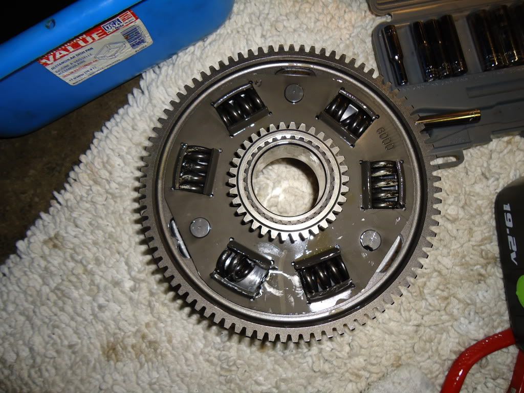

broken Oil pump gear, broken spring on clutch housing? & some case damage.

i got all the parts you need to fix that . thats a 1st time i've seen that happen . did something jam up in the oil pump to cause it to lock-up

Feels good to know what the problem was. Glad it was not a bearing but who knows how serious the damage might have been if that stuff would have bounced around in there long enough. Looks like you saved it with a quick shutdown. I'm curious if the case gouging is even something that will require replacing. If not, should be a fairly inexpensive repair.

Geez....wicked.Whew!I'm seein that clutch spline there..baby got HOT, that's fer sure!I didn't notice mine looking like that when I pulled my basket...is that normal?Heat treated?

Looks like to me clutch got severely overheated and springs lost their temper got bent out of shape and fell out of the clutch caught on the oil pump gear and broke it. There you have solved in a nut shell. Next problem please.

I agree with kawnow.... the spring probably broke and took out the gear. Thats when the light came on.

FYI:
2006-2007 clutch baskets 30 tooth inner ring gear/ 94 tooth outer ring gear, springs are completely covered.
2008 - ?? clutch baskets 30 tooth inner ring gear/ 84 tooth outer ring gear, springs are partially covered.
