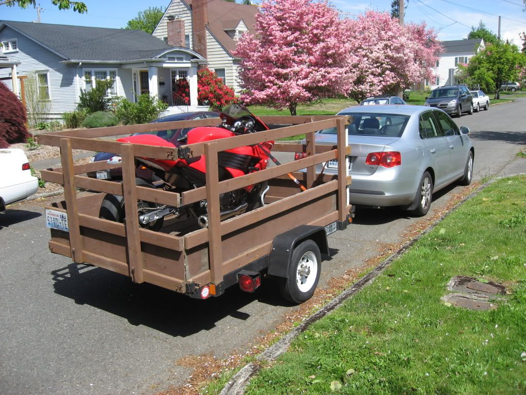

I have the canyon dancer hooked up to my clip-ons. I've probably towed it about 600 miles so far. Works great, and easy to hook up.

Wow I was thinking about using my GTI to tow my bike to local trackdays using a light weight trailer. Have you had any problems towing with the Jetta also what hitch did you buy?

My jetta pulls well, however, I would not recommend it for at gti (but I haven't driven one). I have the TDI model, and the additional torque really helps, and the car pulls right in its torque band at freeway speeds. I don't know that the gti would have enough low end torque.
