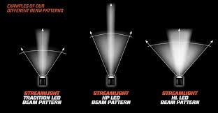

Here is a picture i found on the internet.
The right side is what you will have, except the highbeam will protrude further out. I have a gap right where the low beam ends, because my high beams are still on the stock ajustment. Probobly need 2 turns down.
