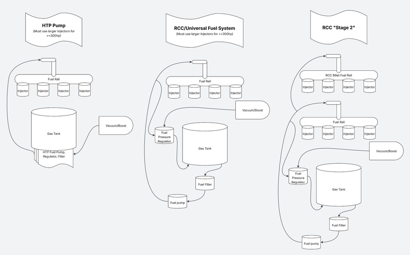

Here is a comparison of "Plug and play" fuel systems on the market. Though you can DIY your own kit- unless it is the HTP kit, it will mimic the complexity of the RCC kit. This is just to show how simple the HTP setup is compared to the RCC setup, which requires running a handful of fuel hoses all over. Instead of a single fuel line to the injector rail.

I see, the HTP Pump has the fuel pump, filter and regulator all in one.
For the RCC systems, I would have thought the fuel pressure regulator would connect to the fuel pump to tell it how much to increase pressure. It makes sense that the regulator gets input from some kind of vacuum/boost sensor but from the diagram, it looks like the regulator is taking fuel away that has already been pumped and sending that fuel back to the fuel tank. ...or is that how it regulates? ... it shuts down flow back to the tank when the boost is high, opens up flow back to the tank when boost is low.

Right so the whole fuel system is pressurized by the fuel pump. From the pump all the way to the injectors. The pressure regulator is T'd off of the main fuel line to send fuel back to the tank past 43 PSI (plus 1 PSI per PSI of boost).
It's an effective setup. However, my fuel hoses are already cracking (another gripe about RCC's kit) and the system adds a lot of weight and complexity. Removing and reinstalling the gas tank is a little complicated. Also the rubber fuel hoses supplied aren't going to withstand ethanol fuels for very long.
I think I will change my fuel system to the HTP setup for simplicity, weight reduction, and Ethanol compatibility. I will also be changing my fuel line to be PTFE hoses for a near infinite lifespan on the hoses for any fuel.
For someone adding a turbo to their bike, the HTP pump is about the same price as RCC's fueling kit. It's an easy choice between the two for me. Reduced weight, very simple to install, ethanol-compatible, same cost, added fuel pressure gauge.

Late to the game, but I second the HTP setup if you haven't gone that route already. Besides the super easy installation (hooks directly to stock fuel connectors), it uses high end Fuelab parts instead of generic no-name pumps and stuff and to make it as compact as possible they basically took the bottom half off the Fuelab regulator and integrated it into their trick billet plate as one piece - slick!
I also do not recommend tuning strictly off stock ECU since while its possible, it does not see positive boost at all, and after crossing over the 0 vacuum threshold or 10% TPS the ECU swaps from MAP to Alpha-N style TPS vs RPM tuning which sucks for boost due to the dramatic difference in fuel requirements between light load at XXXX RPM vs high load/boost at the same RPM. A 1:1 regulator alone was not nearly enough fuel to give me safe AFRs when in boost, and it was hitting 15:1 on the first test drive with just the 1:1 reg setup WITH +10% fuel added above 3k rpm on the TPS vs fuel map. I messed around with stock ECU+Woolich+wideband setup for a while before biting the bullet and ordering a PC5+3bar MAP to build a proper boost vs fuel table since I'm tired of being rich at low load/partial throttle to be safe under boost. The ECU ends up jumping from the low load IAP table during cruise to the high load TPS table and swinging from perfect to rich, which is not dangerous or anything but it is annoying and not the best for plug lifespan. Maybe someone better than myself could take the time to do a million data logs and slowly dial in both tables, but I'd much rather get a MAP sensor that can see boost and build a proper boost vs fuel table :). At that point of a build anyway, whats another few hundred dollars for a PCV/PC6 and a MAP???
