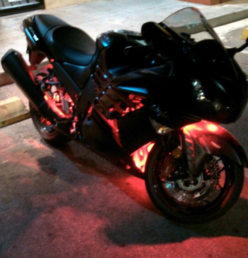

Bike looks great
1. Cblast the ecu
2. Muzzy pipe
3. Good tires
Ride the crap out of it, leds look great
