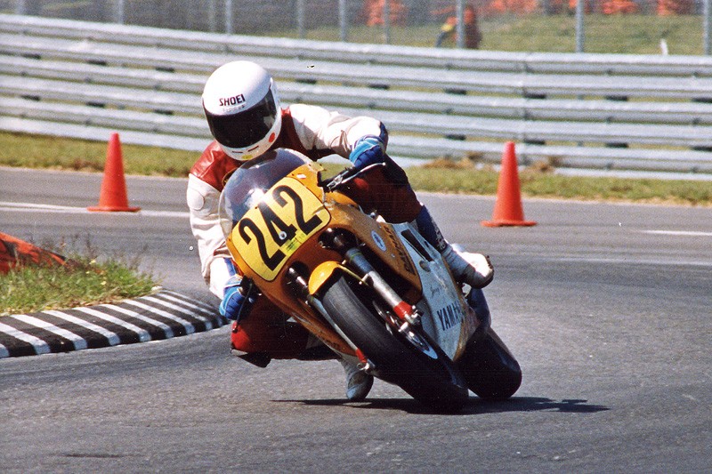

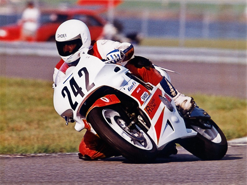

Way back when...(circa 1991), I raced in the AMA Endurance Series.
We ran a GSXR1100 and a CBR600F2. We were a team of limited funds.
We'd run a set of V-rated tires for 3hrs at 180mph+ on the banking of Daytona. (The bike only weighed 400lbs)
Never had a problem.
I think the supersport tires of today are constructed much better than then, I wouldn't worry about an occasional excursion to top speed now and then.
I also ran an RZ350 in the sprint races, it would do 140mph+ with H rated tires...
