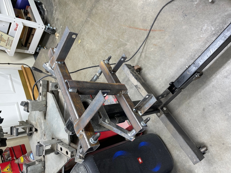

Hello everyone,
I’ve been away from this forum for a long time now. I use to have a gen 1 zx14 that I installed a stage 1 rcc turbo kit on but I hit a deer with it and the bike ended up being totaled. Then I bought a H2SX which was a nice bike but I always missed the zx14. I held on to the H2SX for a while as I started a business making parts for it. Last year I was offered a good price for the H2SX so I let it go and decided to build another zx14. I found a completely stock 2023 zx14 with 48k miles on it for a decent price so I bought it. The miles didn’t concern me as I intended to go through the whole bike anyway and I have no intention of selling it.
I’m fairly far along with the build at this point but I will start from the beginning and post updates when I have time. The basic plan for the build is a stage 2 rcc turbo kit, fully built motor, maxx ecu, and flex fuel setup.

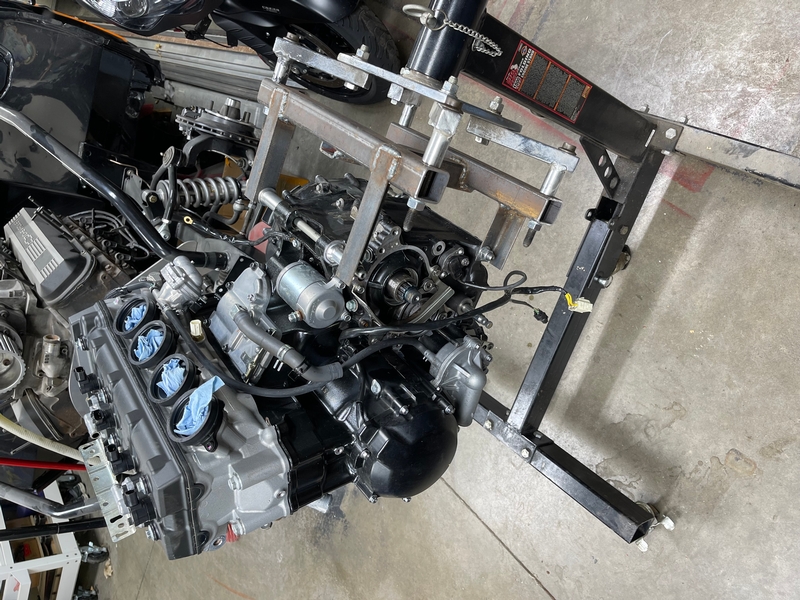

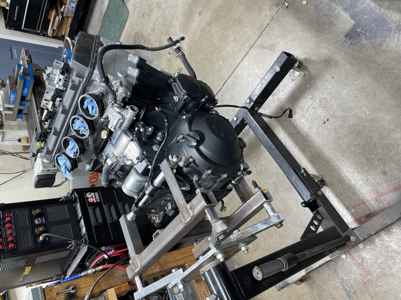

The first step was to get the bike home, pull the motor, and build a fixture so I could mount the engine in my engine stand. Here’s some pictures.

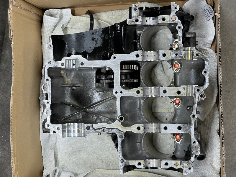

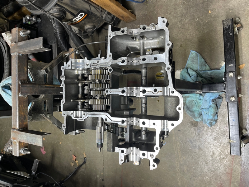

• Disassembled the engine
• Built a front support bracket for the engine so I could split the case.
• Split the case
• Inspected crank and rod bearings

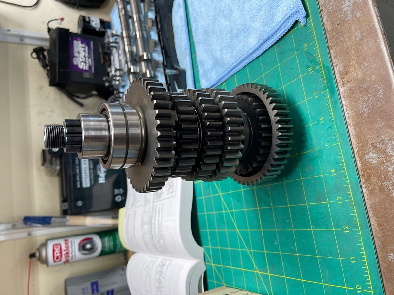

• Inspected transmission gears
• Inspected cams and buckets
• Ordered the first batch of parts

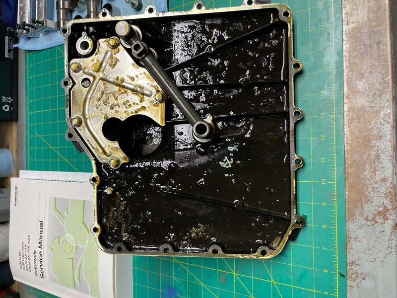

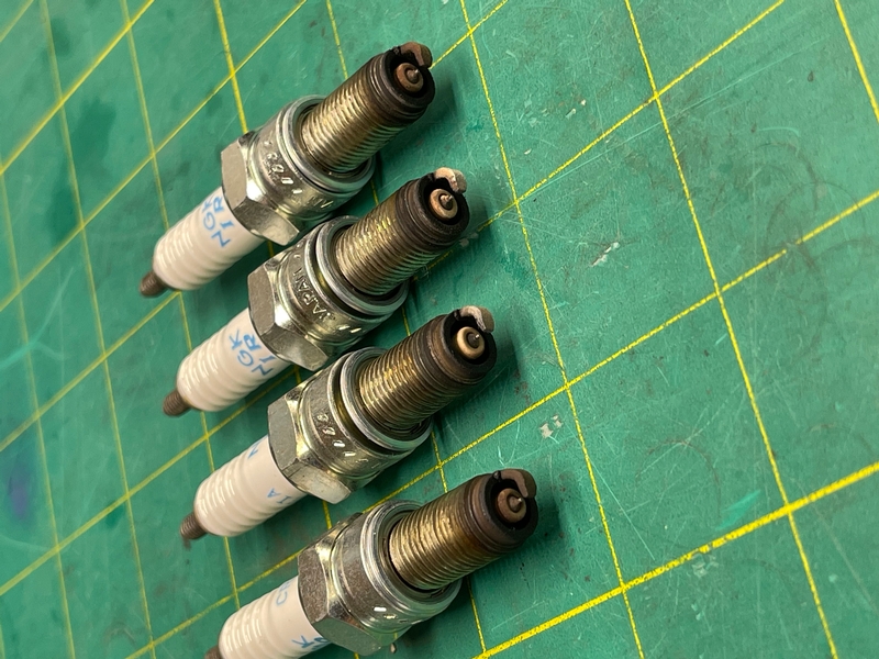

I found that the oil pan had a bit of a jelly like oil buildup on it, the bearings all looked like they were in good shape considering the amount of miles on the bike, the cam lobes had some damage, cam buckets have some wear, some of the valve clearances were 0 on cylinders 1 and 4 so it’s unlikely the bike ever had a valve job done, valve seats are heavily pitted, transmission gears look excellent, output shaft seal was leaking, output shaft collar had a groove wore in it from the oil seal, cylinders look good.
* Last updated by: bryan468 on 1/10/2026 @ 5:55 PM *

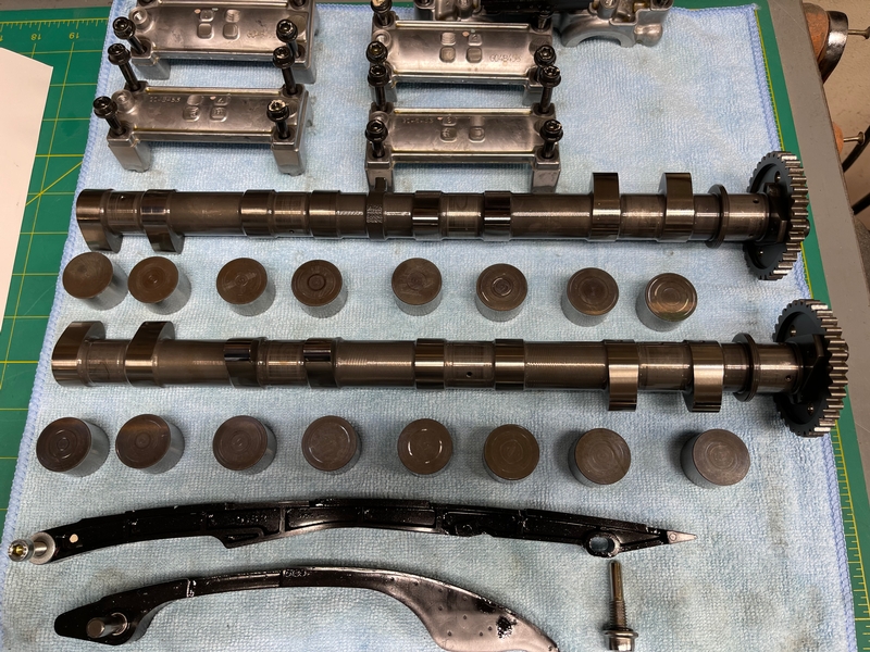

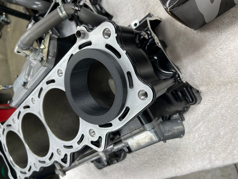

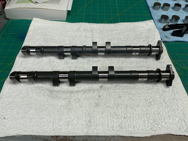

•Due to the damage to the valve seats I decided to send the head out to SRW Performance Engines to have new valves installed, full port job, and carpenter valve springs installed.
• Due to the damage to the camshafts I decided to try and get some used ones off eBay. I tried twice, the first set was not what was pictured in the listing and the second set had the same damage my cams had plus additional damage from poor packaging so I decided to order a new set of .395/.395 cams from carpenter racing.
• The output shaft collar was on back order so I pressed it off the output shaft, cleaned it up, replaced the bearing, and reinstalled it.
• Honed the cylinders to deglaze them.
• File fit the rings.

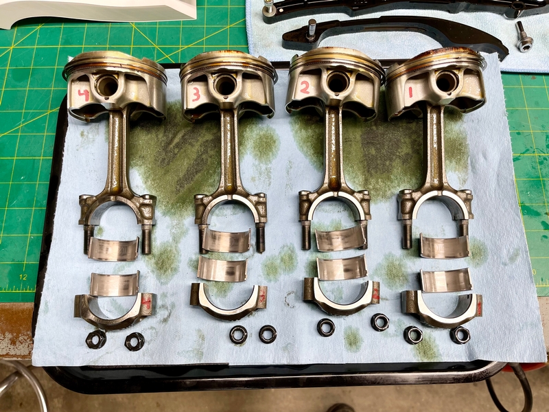

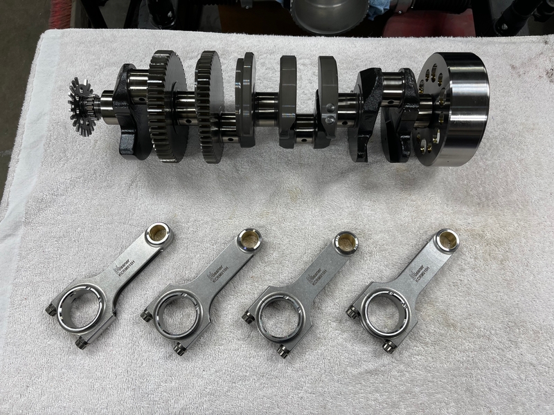

• Installed new rod bearings into wossner rods.
• Checked rod bearing clearances.
* Last updated by: bryan468 on 1/10/2026 @ 5:56 PM *

When checking rod bearing clearances I discovered that one of the bearing halves was different from the rest. The part number had been updated and the bearing was different. I probably could have assembled it with the two different bearings however I didn’t like the idea of having two different bearing halves in one rod. The other problem was the updated bearing half had damage to it. I decided I would just order a new set. The new set of bearings showed up and had the same damage, so I sent an email, a new set was sent to me and only one of the two bearings was free of damage, I sent another email to which I received a phone call, I was told that the damage was acceptable and reputable engineer builders would run the bearings, I refused to run them and finally received a damage free set. This whole ordeal cost me a few weeks and a lot of frustration. I run a business and I would never sell my customers damaged products or try to convince them it’s okay to run damaged parts.

While I waited for a good set of rod bearings I moved on to other stuff.
• Installed APE shift fork shafts.
• Installed factory pro shift star kit.
• Assembled rods and pistons.
• Installed a APE oil pump cover, high volume oil pump gear, and DME pressure relief valve.
• Cleaned the case bolts and replaced the copper washers.
• Cleaned the case halves up
• Installed new crank bearings.
• Installed the crank.
• Put the case halves together.
• Installed 3 of the pistons and rods.
• Installed APE cylinder head studs.
A couple things to note. I was wondering why the manual specified replacing the copper washers. When I received the new ones I noticed they actually have a wave to them and are not flat. I’m not sure how critical it is to replace them but I did.
If you do the oil pump gear you will need to press the old one off and the new one on. I found that it was moderately difficult to press off. You have to support the gear right around the shaft or it will bend and flex. It required a surprisingly large amount of force for such a small shaft.
