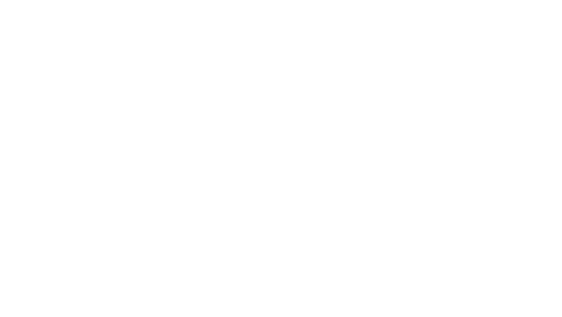

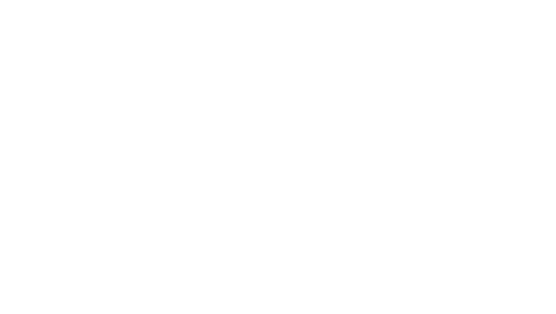

RE: Muffler Painting
05/03/11 9:26 PM
Yeh rook what Slowninja said sounds pretty good as it's temp rated at 1300-2000F so now im doing my modified Header Pipe in VHT Flame Proof Paint,the main thing i've learnt is to not touch the pe- painted areas with un-gloved hands and use a good thinner like Prepsol or an appropiate cleaner and don,t touch it !
* Last updated by: bean07 on 5/3/2011 @ 10:01 PM *
