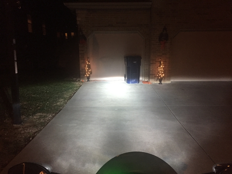

Ok here is a before pic at 25 feet. Which is the distance noted in the manual.

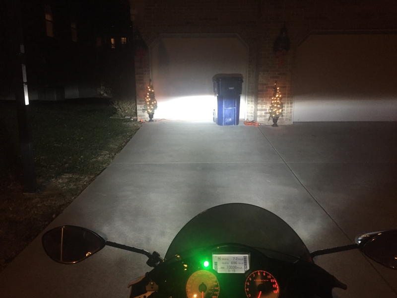

Now after 7 clockwise turns on the adjuster
I still need to test it out on a ride and make sure I am not blinding anyone.

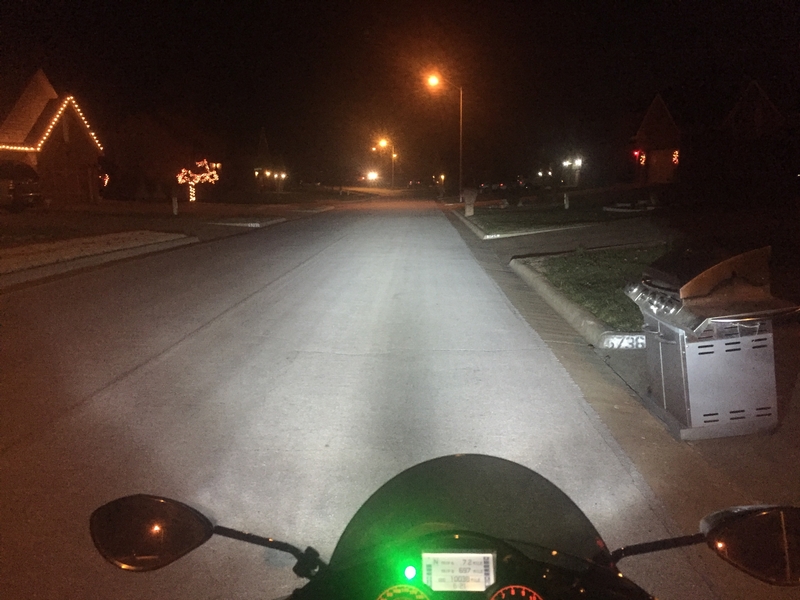

12/19/15 6:34 PM
Street view
RE: Dark of night
12/19/15 7:42 PM
yep that's a lot better and you won't be blasting out other drivers either. Mine are about like that I'd say, never been flashed to turn my high beams off.
