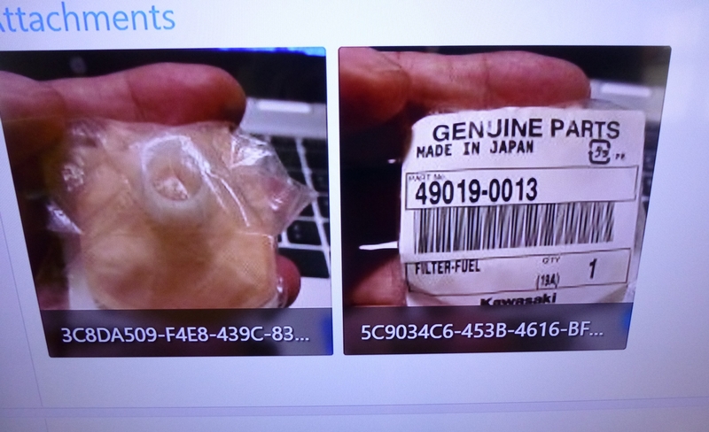

Guys, I put my 06 zx14 in to the shop to get some work done, while it was there they are fitting a muzzy 4:1 system for me along with PCV and qs. I asked the guys to do a baseline dyno run before they changed anything and it showed a problem that never appeared on the road. Resting fuel pressure is fine but as soon as they load it up the fuel pressure falls and the bike leans off, pressure keeps falling and getting leaner until they back off. So they auspected a fuel pump, they fitted a new one and retested it but the same problem is still evident. They were explaining that there is a mesh screen built into the pump housing (output side of the pump), its not servicable and they have seen a few bikes in which these block up. So the only options are a used fuel pump assembly (which may have similar age issues) or a brand new one (au $600 and 2 weeks+ to order from Japan). Has any of you guys seen a similar issue to this? I read that the 08 pump assembly had an improved fuel pressure regulator, is this correct? Will it fit my early bike? I also read that the same part is used from 06 to 11 but I found a new 09 model pump assembly on ebay usa and the seller reckons it wont fit... what do you guys reckon is I should do? Is there anything else that can cause this symptom? I read something about low stator output causing a symptom like this but the stator has been replaced.
