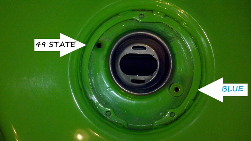

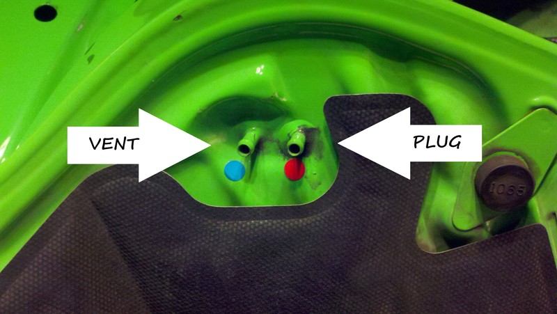

I ordered a new tank for my 10r. It's a California model tank and my bike is not.
So, I'm thinking I plug the red and vent the blue???

Blue vents to nipple just under gas cap... The red runs to just under splash plate to release fuel overfill.
New Q:
Tank still has the 49 state vent also... So can I cap both the red and blue?... Would think I could, but have heard of tanks imploding from this. How though if tank is still vented? Kink in tube running from 49 state vent?
