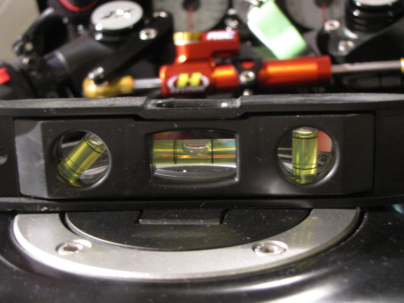

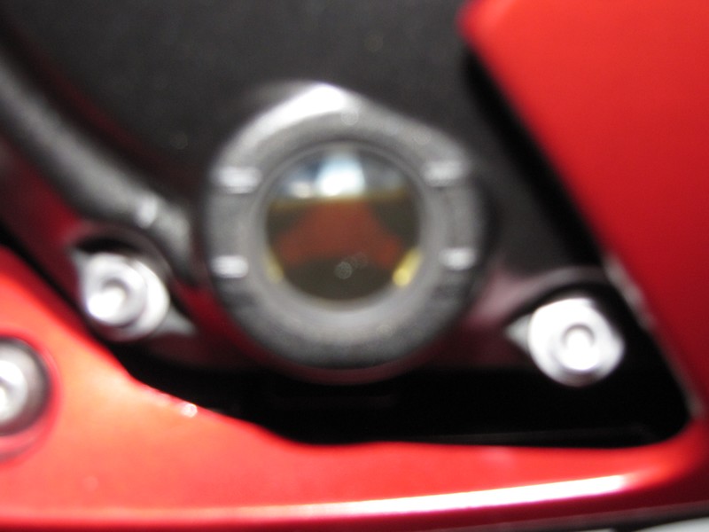

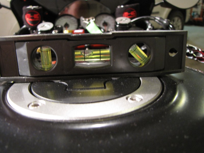

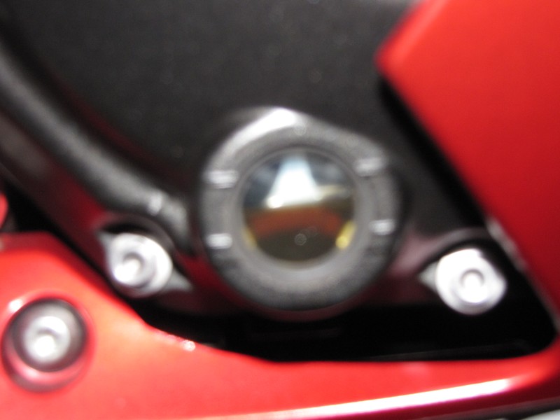

rook this is a good example of what your saying the first 2 pics are on the rear stand:
these 2 are on side stand with a 2x4 and 2 paint sticks under it lol
tomorrow ill try to find a level spot for the stand and see if theres a difference being on the stand thats level.
on a side note to me it looks like the oil is more horizontal in the sight glass with bike on the stand.
* Last updated by: scottjkyl on 2/29/2012 @ 7:09 PM *

perfecto! yeah that shows what I was talking about!
friggin A, scotty!!! I must say I admire your precision there! A freegin bullet level!! hahahaha! Love it. You outdid yourself this time. Have to check the shelf next time I am at the hardware store.
