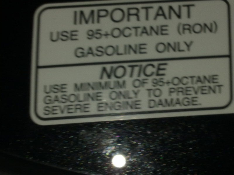

RE: What gas?
04/27/12 6:04 PM
Their must be something completely differant with the emissions on USA ZX14-ZX14R to
* Last updated by: bean07 on 4/27/2012 @ 6:08 PM *

RE: What gas?
05/03/12 2:15 AM
bean07. not sure if your aware, the 95ron rating in your pic is just a diff way of calculating octane than we use in the USA. IIRC we us R+M/2 95ron = 90/91 rm/2 depending on where you get it, etc.
Best octane we could get in Michigan was 94 at RM/2, which would have been RON 98. but I believe its been discontinued, so were stuck with 93 in this state. some states in the us can only get 90? or 91.
