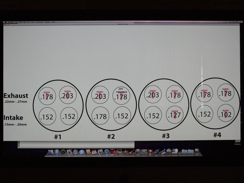

1 bad says .006" intanke, .009" exhaust is optimum(those are both the minimum spec). Hub says going wider is better than tighter because obviously you will have to readjust sooner if you go on the tight end.
Her's mine at 29000 miles.
metric
inches are a little easier to conceptualize. Nice neat round numbers. (.006 .007 .008....)
THere is the thread That Hub has been giving me so much help on. We plan to do a How - To on valve shim clearance but YES, it was an extraodinary amount of work and will have ~$300-$400 in tools and parts sunk in it if you replace shims, gaskets, plugs and maybe do a quick Tbody sinc.
I removed Tbodies. That was not necessary but sure opens up that cluttered hole under the airbox. Really, J, this is aboiout 7-8 smaller jobs rolled into one huge procedure. None of the small jobs are anything any of us couldn't handle but all together, first time doing it---we are talking prolly ~100 hours of work. That seems insane but I guess and then double and that usually ends uo being about right. I am working full time and overtime ~ every other weekend which kills any opportunity to do anything. The 14 has been out for aprox 10 weeks. I estimate another 30 hours. to reshim and put all back.
It's a really great learning experience, though. I don't wish to scare anyone off. I believe the How Tos will cut the time in half but you can see we are still talking a sizable chunk of time.
* Last updated by: Rook on 8/16/2011 @ 3:42 PM *

Thanks for posting that chart Rook, that gives me an idea of what to expect although I doubt I'll wait till 28,000 to do this, probably get her done in the next few thousand miles.
Back to original question, Hub, 1Bad, looking at Rooks numbers, did he do any damage or still OK? #4 intake looked a bit tight at .004".
The way I see it, the mfg gives you a range to play with, target +/- .001" to shoot for. If you set 'em up initially on the tight side of the range and they're going to wear in the next 15,000 miles, you're going to have some tight valves like Rooksteer here, they know that. No avoiding it. Does it hurt anything though? I think the Rook caught 'em in plenty of time. Just my .02
