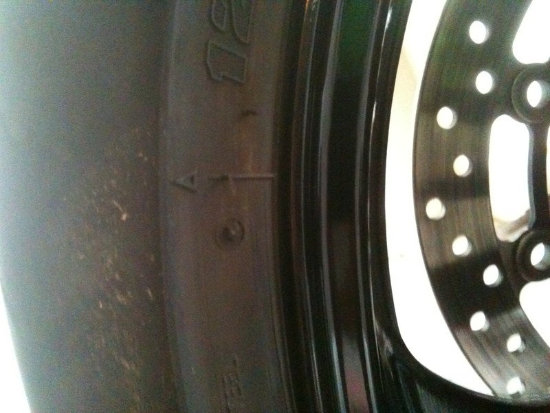

OK, Hub got another tech question for you. I was out on my CBR1000RR about an hour ago. Was doing a left hand overpass, I'm guessing maybe 100 mph or so. I have the bike leaned over pretty good in the right lane and I'm sweeping around a slower moving vehicle in the left lane. No time to react, I hit a wooden board pretty near full lean. The bike seemed to handle it fine and I road back home at reduced speed. Put the bike up on the track stands and look it over. My worst fear is realized, ding in the front rim bead area on the left side. Tire is almost new and has an impression from the bead at point of impact, kind of a smiley about 3 inches long. Definitely must replace the tire but what about the wheel? What other damage should I be looking for here, forks, steering neck, stem bearings, wheel bearings? Rotors look fine, I can see no runout with a visual and normal brake drag, maybe two revolutions with a hand spin.

I'll try to get a pic of the rim, hard to see anything, very minor but I can see the bead of the rim has a bit of runout, only visible really when you spin it, you can see a hop right there at the impact point.

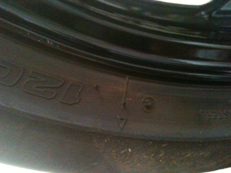

Liability/comprehensive only, this is on me, trying to decide if I need to replace the wheel. Wheel is not bent, just a flat spot on the tire bead lip on left hand side. Tire sidewall is not cut but left an impression in the rubber. I can't post pics from my iPhone so sent them to Rook to post for me.
coming right up bud. Glad this was just a riding bang up.

Wheel ding
wood in tire
* Last updated by: Rook on 4/27/2013 @ 12:02 AM *

Glad to hear your okay Kruz! Feel your pain, you were riding my favourite bike the cbr. I read that Hub suggested scuttling rim and tire for new. I agree. Though when I look at the rim, it appears to have only suffered scratches. New tire, murphy's law something is bound to happen. Take care buddy, I'll stay tuned to read what the Dr. (Hub) says

Wolfman, you have to look very close but the damage area is just below the arrow on the sidewall in that lower picture. The light tan fibers are wood fibers from the board so you can see the impact zone. It is very light damage but the bead lip is flattened. If you look closely, the gap is slightly uneven where the tire bead seats.
OEM replacement wheel is $500.
OK Hub, it's a fairly minor ding but still considering replacing everything.

Sometimes spending a little cash is the best option, especially when your butt is on the line. I took it into the local Honda dealer and had the service manager personally check it out. He said the forks and bearings are fine, slight ding in the rim bead area but not bad. Recommended I change the front tire if I'm going to be pushing hard so I had him spoon on a new Michelin Pilot 3 while I waited. Spin balancing showed 10 grams out of balance with no weights which he said was excellent. One hours worth of time and $207 and I was on my way. OK, bottom line is this could have been much, much worse. Bike feels great, took it up to 100 mph on the way home so I'm good with it. HubMeister was pretty much in agreement with the S.M.'s assessment. Good job Hub!

Looks pretty minor. That's a easy cosmetic fix. I'd leave it alone or you may take out the finish. I had to spoke up a bent Harley rim with way more curve than that. You'll never feel it, Kruz.
