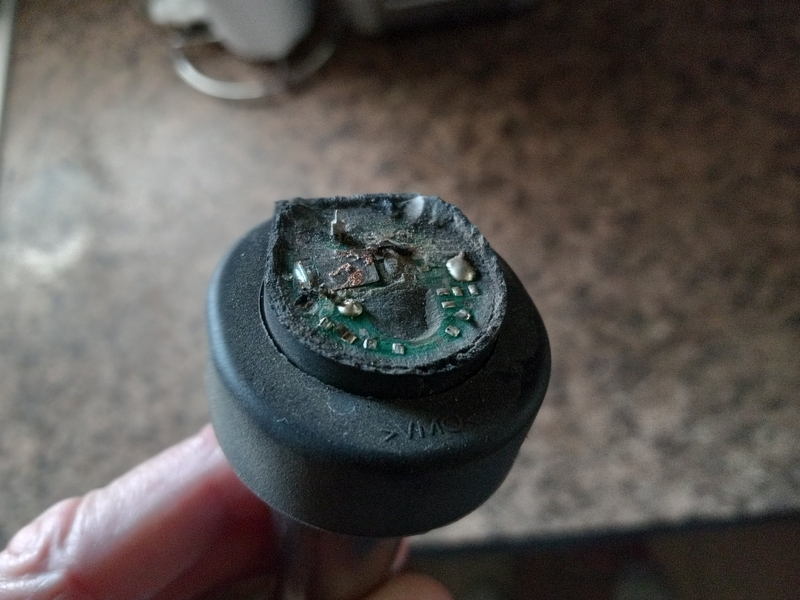

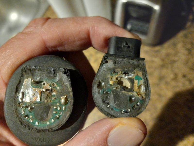

Well Hub, new ignition coils and plugs finally arrived and I got around to changing them this morning. Here's what I found when I removed the tank and airbox, top photo. The top of #4 coil was completely separated from the bottom half. Installed new plugs and coils and fired it up and.....nope, still dead on # 2 and # 4 cylinders, not #1 and #3 as I reported earlier, that was a typo. It appears there was a lot of arcing going on for some length of time at #4. Plugged in GS911, no codes, everything looks fine. So, I'm now out $1100 for plugs and coils and 3 hours of time and bike is still dead on #2 and #4. What next, new ECM? My thoughts now are all the arcing at the #4 secondary fed back into the ECM and smoked coil drivers for both #2 and #4 although I don't know if those two are connected at the coil drivers.
* Last updated by: Kruz on 9/8/2025 @ 9:56 PM *

09/09/25 4:29 AM
Here is what I found when the fuel tank and airbox came off.
* Last updated by: Kruz on 9/9/2025 @ 4:31 AM *

That is sad. My only guess was a twist and not a pull first caused that? Has to be a brutal pull up. I can't see something like that just loosen itself and lay dead in its side. That means no follow thru to ground but a backwash from DC to AC back into the ECM.
Looks like an ECM to fix it. Wonder why no code for each cylinder. On the ZX it cover codes for spark.
2nd owner BS is more call BM and see if they'd do a good-service by offering a new ECM. Might get them on a 50,000 mile epa status on emissions. I recall that is the mileage window to no charge to the customer on a fuel related issue, meaning, emissions related.

I'm a bit rusty on my Hubbish but it sounds like you are saying previous owner or mechanic strong armed the coil during prior maintenance and cracked it leading to complete coil failure and separation? High voltage fed back into the primary circuit and destroyed coil driver transistors. Makes sense for #4 but why #2 also and was this what caused my TFT to change modes from Race Pro Customs Settings back to standard Race Mode? That one had me puzzled, first thing I noticed when it shutdown and yes, there are no stored internal fault codes of any type and no warnings on the TFT display.
