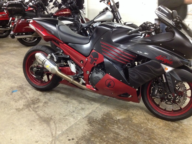

Yeah, the great news about the gen I is it can make great power. Never really tore one up before. But here is a another customer we helped today. Very nice gentleman with a set of 6" extensions and a 200 rear tire. Also had a PC III with a canned map and some slips-ons with a stock header. Flies in. Stock ecu when we started. Awesome results. Started his first run and he pulled 169hp with the PC hooked up. Not bad for a stretched big tired bike.
When we were done he was thrilled! Left with 180+Hp and 110. All flashed through the ecu. He left with the power commander zeroed out. Absolutely flawless A/F line too! Nice to meet ya Zack! I think that's the gen I flash buttoned up!
