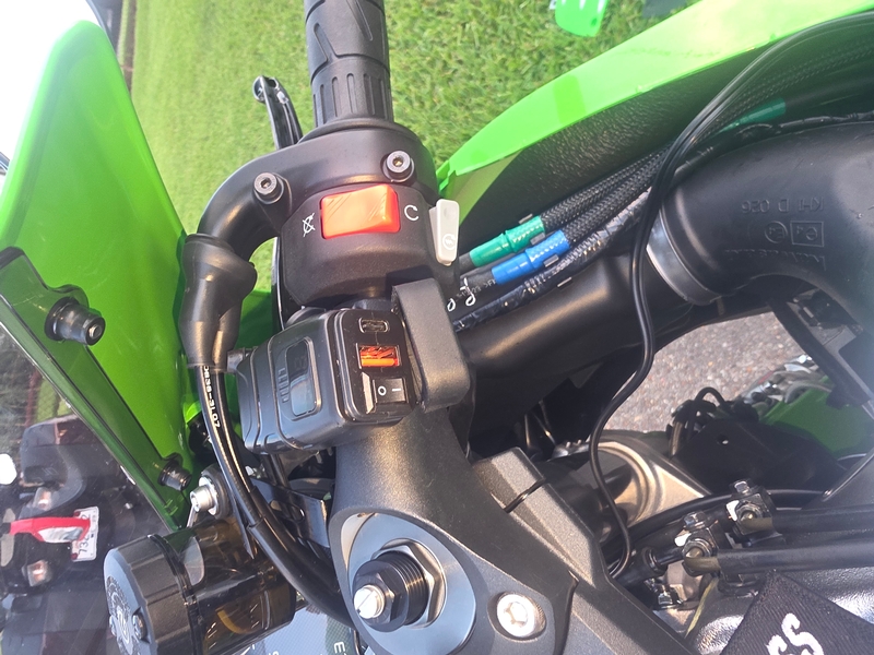

I just wanted to share my usb charging port install with everyone. It was a quick and easy option and cheap as well. I got the charger on Amazon for $17 with two day shipping. It had everything needed for the install, so nothing extra was bought.
Here it is below. I have a galaxy s25 and Google pixel and it does support fast charging and super fast charging. I think i get to 80% in 30 mins so it works great.
https://a.co/d/cU25yTM

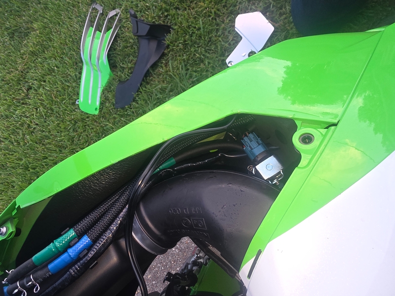

I installed it on the handlebar next to the throttle side. It has a pad you put around it before the ring so it gets nice and tight. I ran it hot to the battery so things can charge without having the bike on. It has a switch next to the ports and pretty bright voltmeter on it which is good about reminding to turn it off when done. All I did was take off the right airduct cover and the top side if the right fairing to get to the battery. I ran the wire thru the bracket with the brake lines and went over the duct and behind the fairing right to the battery. Positive to the battery and negative to the body. Use some tie straps to clean it all up. Then put it back together it took about 30 mins very glad I took the time to do it. Hope this helps someone they wants a charger

Did you use a fuse on the posi side of the whole loop?

There was an inline fuse in harness of the charger so I just rolled with that one.
