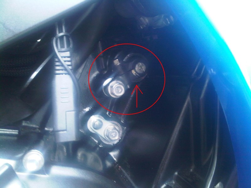

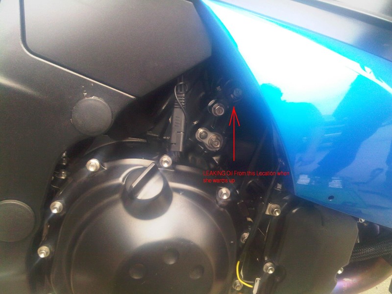

Hey Guys I need your HELP once again.
I rode to work today and when I parked I noticed some oil leaking from the bike. I took off the lower fairing and tried to see where it was coming from and and the following pictures will show you where and what im talking about. Any Help or Solution would be very apprieciated. Snuffy
* Last updated by: SnuffyZX on 5/13/2011 @ 5:12 PM *
RE: Need so Help with a Oil Leak
05/13/11 1:47 PM
Status is: A 92049-2204 = $2.00 or under for the seal. Over that = Gouge.
05/13/11 2:29 PM
Hub I have nothing but LOVE for ya and I need a little work with my Hubbish but am I too understand that its a O-ring leaking that cost $2 bucks but the job is such a fiasco that I should just bring it to the dealer and get gouged in the buttocks? Let a brother know!!! In english if you would my good man.
Thanks for the Speedy Reply.
05/13/11 11:30 PM
Hub is keerect again!However...just to exclude any possibilities...did you check to see IF it's actually NOT DRIPPING FROM ABOVE somewhere?And I also noticed....hummmm...looks like that "arm/bolt" deal there has previously been tampered with?Those balancers shouldn't need any adjustments.... .
* Last updated by: blue07 on 5/13/2011 @ 11:32 PM *
05/13/11 11:42 PM
Hey Blue Thanks for chimeing in....You decifer hubs knowledge very well.
It seems to be coming from there but I could be wrong I will take the fairings off over the weekend and make sure thats where its coming from. As far as the Arm/bolt goes I havent tampered with it but maybe the dealer did when they rebuilt my engine? As far as those balancers go if they where out of adjustment would that cause the bike to run with more vibration? Since I got the bike back from the dealer about 700 miles ago the bike doesent seem as smooth as it used to be.
Thanks
05/13/11 11:51 PM
OH...they REBUILT your motor.Ya...IF they didn't get em set right...she would feel more rough.Definitely looks like the paint or metal has been scratched or something right there....There's a how to in the manual....but someone here maybe could help ya through it.Ya...makes perfect sense now since you mentioned the motor repair.Yup.I read a bit about the adjustment in the manual a while back.Seemed easy enough.One man job.If she felt more vibey...that's most likely what happened.I believe it was the Hubster who talked me out of adjusting mine."If it aint broke"...you know.I just left mine alone after his advice.She's smooth as glass anyway.
* Last updated by: blue07 on 5/13/2011 @ 11:55 PM *
05/14/11 12:40 AM
Snuffy,
If that is a seal leak, you see it was not broken by the lock arm to balancer shaft, you looking close at the paint being chipped off, then who the hell put that engine together?
Like blue mentioned, is this residual oil now showing a peppered dirt cling to it? Is this a puddle of oil running down to the bottom of the case where the clutch and crank meet in that valley?
The work is called... No Nicks on the case or the shaft.
This is how I remove seals such as we have behind that shaft locker. I have a 700 mile leak and you see it now? Say, what are the odds that leaked the day you picked it up and now??? I think you have some shottie work that didn't last 1000's of miles like mine does not leak a drop and how come they used the same parts is parts in your bike? So, do you take it back and get it looked at with fairings off? Do it yourself and look higher so you know it's the shaft or valve cover coming down from there.
And say, if you rebuilt a whole new engine, would you not have a different gear meshing with a different gear and now you have a vib? Do we want to move those balancers to see if they were moved at all and maybe you luck out the vib left or say; Chain for sprocket tooth to gear from trans off crank case match is match trans gears and now the bike might ha've split case will travel up a vibe = Nothing matches gear to gear to chain to tooth bad, guy.
05/28/11 8:33 PM
So I purchase the new seal and drop the bike off to get the leak fixed last saturday....the dealer is packed with bikes so I give the dealer a few days and give them a call on Tues. they say havent even looked at it yet. I wait 2 days and call again on thurs at 4pm and they say they are just very busy and they will call me when its ready. So with memorial day weekend about to kick off and the weather will be in the 80's and 90's I need my bike!!! So I tell the dealer if he can get the bike fixed before 4 pm friday he would get $100 bucks in his pocket for his troubles.....Friday at noon I get the call ...Your bike is ready come pick it up....so the old saying CASH is KING is still in effect!LOL
Happy Memorial Day Guys!!!
