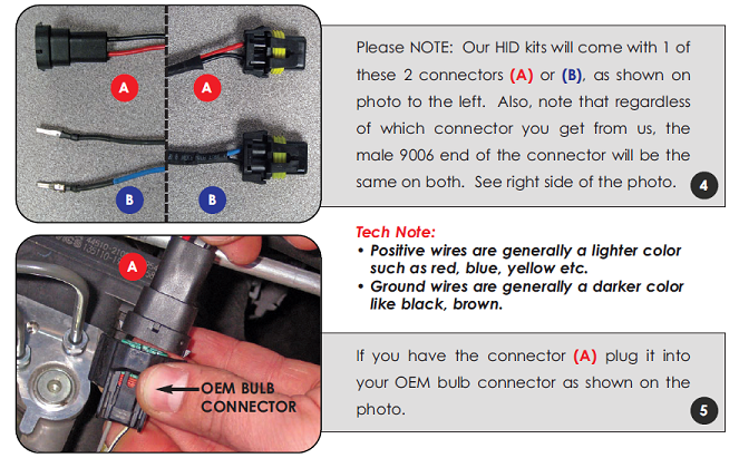

The only 2 complaints I have with the DDM lights is the H9 dual set came with the the supposed to be "plug and play" wire which wasn't it was this blue and black wire that comes off the ballast and ends with 2 electrical plugs which you plug into your OEM low light harness which I didn't like so I snipped the OEM adapter off and crimped the 2 positives and 2 negatives together other than that the H11 were perfect plug and play kind of loose so I Zip-tied the conecters together so they don't fall apart. The other complaint I have is why is the H11's the High's show a bit of blue at start up but after warm-up about 30 seconds it goes away so really not a complaint just an observation. here:

Thanks Blue
Info for everyone this helped:
My H11's came with connector A which was easy and my H9's came with connector B which I hard wired....
