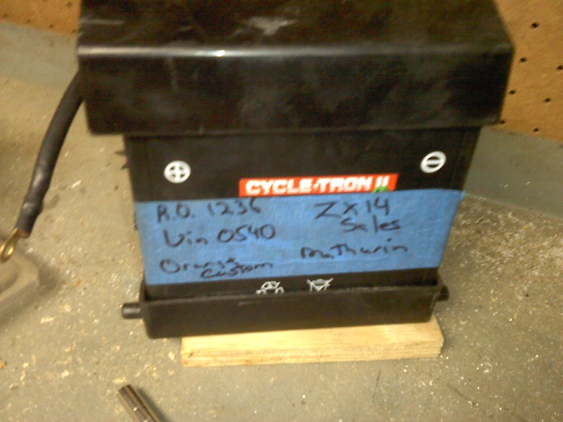

I also have a 2010 and 2700 miles on it bought it leftover spring 2011. I was having slow cranking issues when I let it sit for a couple weeks. I bought a battery tender to trickle charge over the winter. To my surprise when I removed my battery I had an old battery out of a 2006 ZX14 Cycle Tron II battery. Not even a factory battery. Had tape with all the info from the bike it came out of. Might want to check yours. I called the dealership and they could`nt believe it also.... they ordered me a brand new one and it cranks alot faster than the old one.
