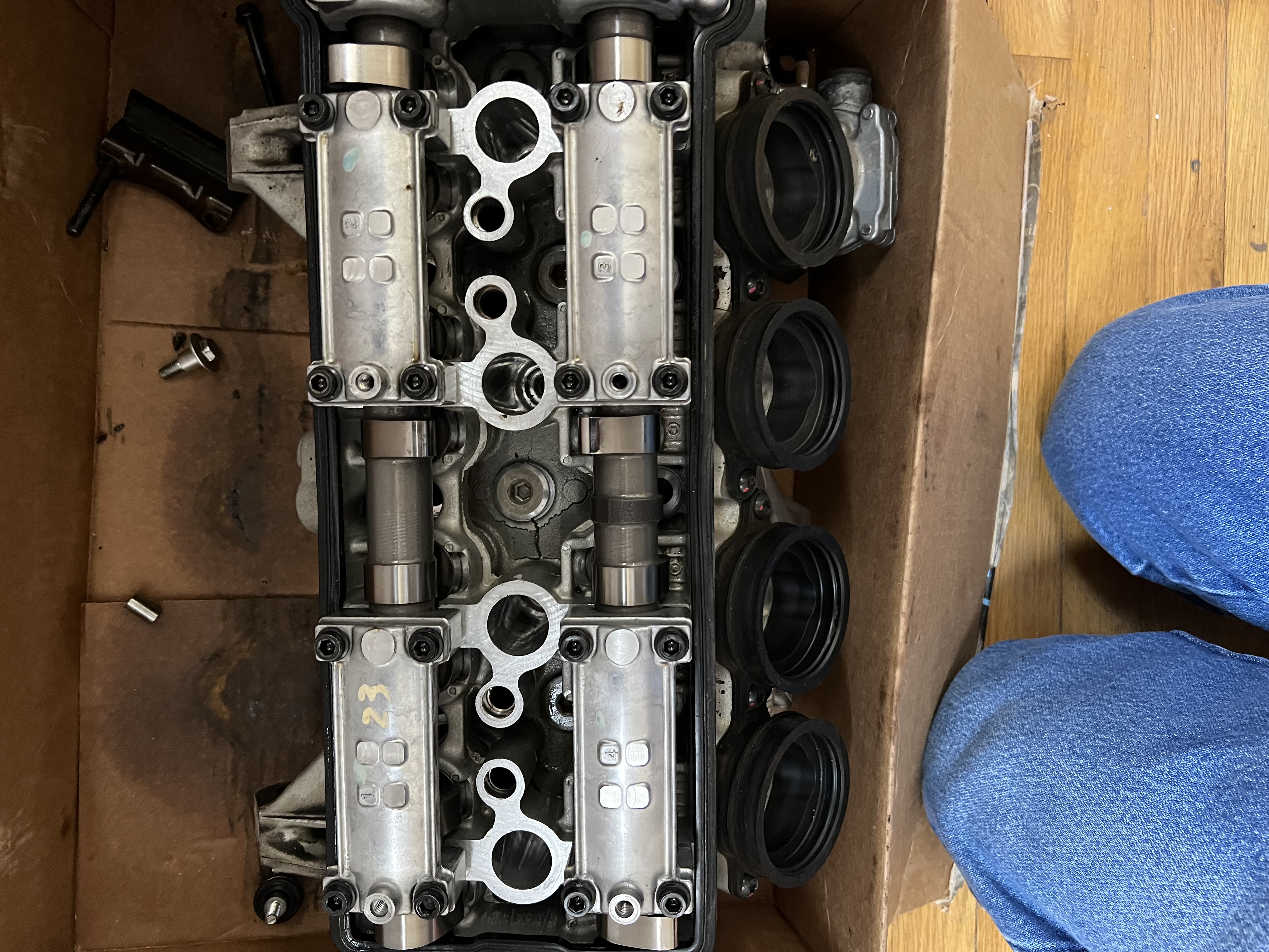

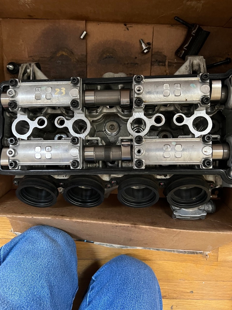

Well....Finally remembered to pass on the info . I have put the 14 in a corner till next year as SS only stretches so tight :)

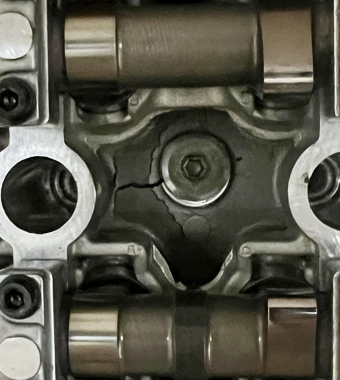

It seems the head is cracked. As you can see in the photos ( I hope), what I assume is a crack due to freezing temps in the garage in Montana last winter. and that looks like a freeze plug to me ?
I am thinking that with the water in hte crancase, bearings are not in real good shape so I have , at this point, just set it aside until I come across a motor I can pick up .
full head shot
close up. Do you see the crack on both sides of the plug ?
I could not see any further evidence of crack expanding
I was told teh bike came out of the garage, fired up rode approximately ten miles and began loosing power, immediately shut down and trailered the bike back home .
I went a few months later and picked it up .\, brought it home and started it , listened for five seconds and shut it down . I did not hear anything unusual . Pulled teh oil drain plug and after it was empty I began filling the radiator with water . When the level in hte radiator was approximately level with where the crack is in the head, the water began pouring out of the oil drain plug .
Pulled the head and found the crack and that is kind of where I am .

Being that kind of weather changing effect, I'd more drain the coolant each season to avoid the expansion. Coolant might not have the chemical makeup to avoid this, i.e. diluted? Did you use the pink coolant just in case the engine blows on the track?
Posts: 22076
RE: Water problem
09/10/26 2:59 PM
WOW chrly! Northern Wisconsin and Upper Michigan here and never had that happen with the bikes stored in unheated, not attached garages. I've changed coolant a few times and always found the flush water to impact the 50/50 mix significantly. I get the mix balanced after a few times draining and adding pure coolant. Four balls is what I aim for. I'd like to see five balls for confidence in the coldest days of winter but then it seems like the coolant is richer than 50/50. Go for five balls during storage and lean it out during the riding season.
A whole damn new motor! It is probable other parts of the motor are cracked if the head cracked. Save the original because I'm sure there are lots of parts that were uneffected by the deep freeze.

Not positive about pink coolant ..
I haven't heard of any brand of coolant having better or worse anti-freeze protection aside from how much water it's mixed with.
It seems odd that the radiator wouldn't have been damaged if the coolant froze. I would think the radiator would be a lot more vulnerable to coolant freezing than the head.
