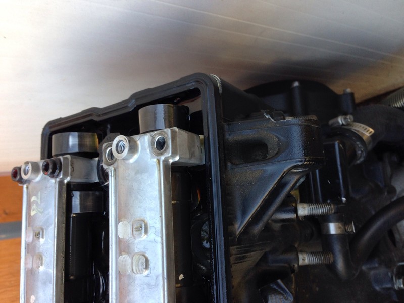

Here is a neat photo showing the oil pooling in the left front of the engine while on the side stand. I used 2 washers on the left side valve cover bolts. No leaking after that.

...just make sure you don't over-tighten them. You see the raised hole on the camshaft cap in fazers pic above? That is what you are screwing into. It'll strip pretty easy if you go too tight.

Also, if you tighten it too much you will squish the gasket into the spark plug wells and make it extremely difficult to pull the coil sticks.... Ask me how i know
