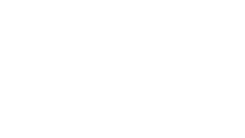

bean, where did you get your center stand?
RE: Pulling the bike apart...
08/26/11 6:47 PM
This place worked out alot cheaper than where I got mine from BigBlack06

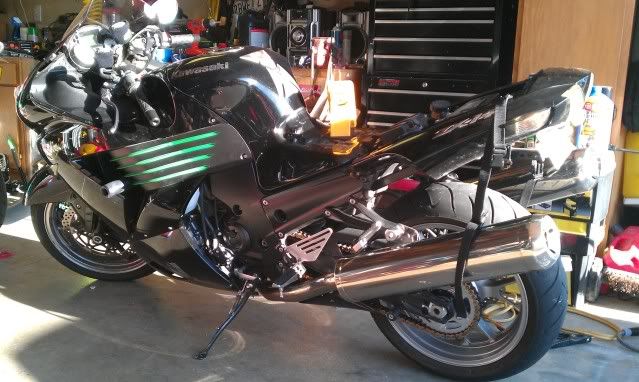

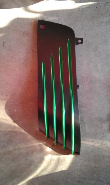

08/30/11 7:55 PM
Alright, got some pics for you guys...
The painted grills...
The dash...
Still need the new windscreen and to finish painting the brake/clutch caps along with the mirror ribs and front fender ribs.
* Last updated by: BearsZX72 on 8/30/2011 @ 7:58 PM *
