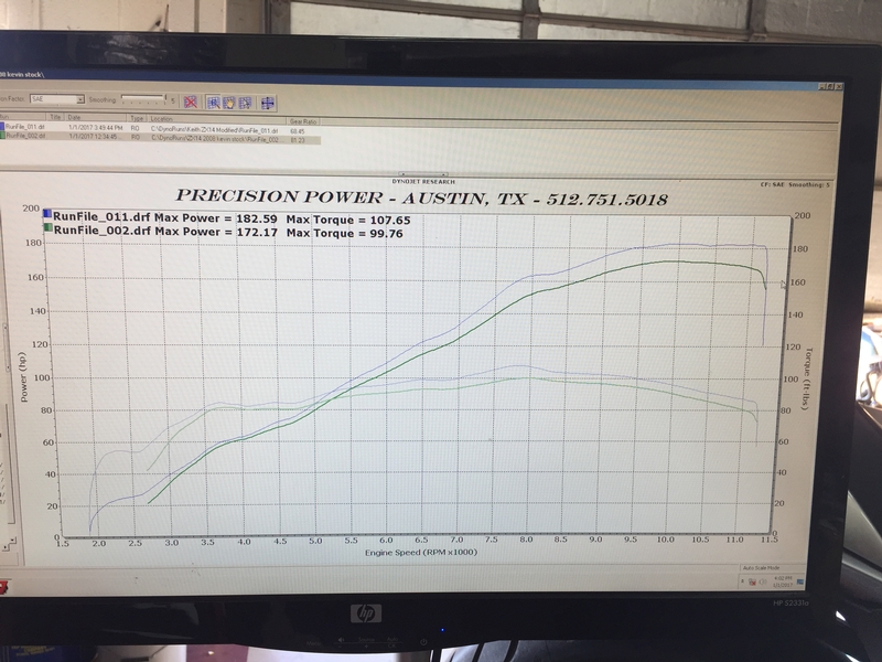

Had ECM flash and dyno tune today...picked up 10 HP and 8 ft lbs torque...are these numbers ok for a 2008 with 22K miles...for some reason i thought that was a little low...

The fact you gained 10 HP is great - that's all that really matters. The run numbers were about the same as my '06 after the tune

Finally some good news...found a great mechanic who did a complete major service and ECM flash and dyno tune...finally got to ride it and it ran great...had a dead spot at 3700 rpm before and thats gone finally...the 2 different ECM flashes i had before were way off...one had almost nothing done to it and the other had waaaay too much timing in it...as much as 36 degrees at lower rpm's...shop owner said theres absolutely no way you can flash an ECM properly without your bike being run on a dyno...

Hey there stang. Your tuner must know a heck of a lot more than I do but seems to me a good flash tuned on the road at close to your altitude with similar mods should be very close to creating as perfect of fueling as a custom tune. Ignition is a standard map. A good tuner knows what generic curve to program and the same timing will work pretty much the same for every Gen1 zx14. Cooling fan and rev limiter are also generic in that it is known what works best for all. I'm sure every bike will benefit from a custom tune but I don't see the numbers changing a huge amount from any good tuners map. They all know the best AFR and the best timing. I think you just got someone who knows what they're doing this time so i'm glad for you.

I speculate that this mechanic is describing how its not possible to tune an engine without a dyno, as in, to build a higher performance fuel & ignition map from scratch without any feedback as to whether or not the changes you have made to the stock map have actually improved the performance of the engine.
Not the more literal translation of "no dyno = no flash"

Im by no means knowledgable about ECM flashing so maybe you guys can explain...i guess the term GOOD flasher is suspect...is it normal to have 36 degrees of timing almost across the board on one ECM and virtually no timing on the other?...both of these came from recommended flash experts on the board here...my tuner said absolutely no more than 16 degrees timing in the spots that had 36...please clarify for me...both flashed ECM's were sent to me and not done on a dyno with my bike...

A good map for performance would have the ideal AFR number which is somewhere around 12.8~13.1 for Gen1 if i recall. If the fueling hits that AFR, you have the best fueling for power. That is probably as complicated as it pays to get. I really don't think slight variations in the AFR are going to be easy to notice unless you're paying very close attention. From there we could talk about individual riding needs and that would give us reasons to shoot for different AFRs in different parts of the map. If there is something peculiar to your engine, a custom tune would have a lot better chance of improving that over a regular flash. If somebody flashed your ECU fueling and barely changed it from stock, that probably was not very good map---no idea what went on there.
From my experience, going from tuner A's map to Tuner B, the change was not easy to tell without really opening the throttle. Then refining the map with Autotune and shooting for 13 AFR in all cells, well, I got pretty close to hitting it in two runs most of the time which tells me, the tuner's map must have been real close. I did not notice a big improvement from my refinements with Autotune. I think if there is any real magic in tuning, it comes from the tuners choice of target AFRs. That is something that requires some thought and creativity. Just hitting any AFR you want to pick is pretty cut and dry as long as you have the equipment and know how to use it.
Timing is something i have not gotten into enough but Romans told me the stock Gen1 timing is already very edgy. I don't want to confuse the issue by using incorrect terminology but stated plainly, the engine is firing closer to TDC with stock mapping than he would like to have it. People who try to cause ignition to occur a sooner hoping for more power are blowing their engines up and blaming it on not having proper engine building. Romans was runing over 300 hp on his turbo bikes with all stock engine parts.
I hope I got that correct. The gist of it is, the timing that generally creates better power is already present and going farther in that direction by tuning is asking for trouble. I do not believe there is reason to vary from the timing curve that is known to work best on the 14. What works for one 14 works for all. I suppose one tuner might be willing to take a bigger risk than another but if the engine is running without blowing up, I don't see that there would be a big range in timing maps. If you had 36 degrees, that sounds like a lot but it depends if it was advanced or retarded and here is where I get my terminology mixed up so best to leave it at that.
Just googled and seems to me if you were retarding 36 degrees, that may have been a tuner who was being more cautious. Does seem very questionable that they used the same timing throughout. Timing is normally optimized according to rpm and there is a curve, not a flatline.
