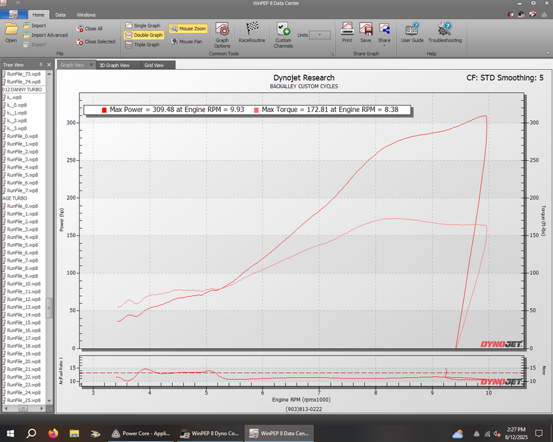

Final Dyno Figures:
316 horsepower
178 torque
At the wheel
Conditions: 95F, 65% Humidity
I am having trouble getting the last graph from the tuner. The bike started to cut-out from 7-8k RPM after it was warmed up. The tuner told me it was from the spark plugs. That he ran into the same problem on another turbo ZX14 and replacing the plugs was the solution. Weird but at least he knew what it was right away. The argument could be made that maybe the bike wasn't making the power it could've with the cutout happening right when boost would start to hit. I asked if maybe it was "blowout" where cylinder pressures spike from boost and blow out the spark. Tuner assured me that wasn't the case. Luckily the spark plugs used are on Amazon and can be delivered in a day or less for $40 a set. Moving my gap from 0.017" to 0.020". If condition is unresolved I'll look into closing the gap to 0.017" again just to see if it helps.
Here is a clean run on the bike. RPMs stop at 10k but I planned to run it out to maybe 10.5 or 11, so maybe a little more power there as well.
Not the figures I heard but I'll add another graph once I can get my hands on one.
OLD GRAPH:
Overall less power than I expected. But still a lot. I might turn up the boost or go a different route with ECUs soon. But 300+ at the wheel is plenty to play with for a while.
* Last updated by: danmin on 8/13/2025 @ 10:10 AM *

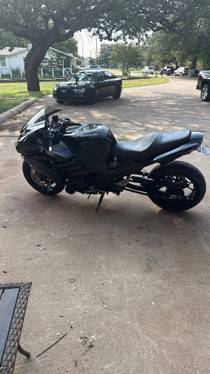

Fairings installed. Just waiting on the ECU tuning to wrap up. Taking it to a local car meet tonight

The bike looks incredibly cool Dan! I'd run it without the lowers a while to show off that badass turbo.
When I get mine, I think I'll eventually convert to a longer filter and separate exits for exhaust and waste gate. It's not going to be much of a cornering machine after turbo.

I think I'll run it without the lowers. I was going to install them but frankly I'm too lazy to cut the necessary holes for the exhaust and filter. Plus it's nice to see the whole turbo sticking out.
