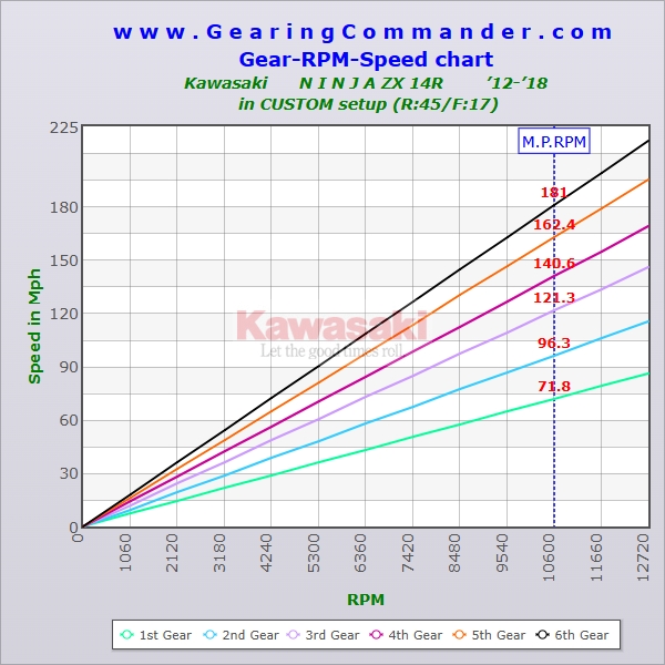

Yeah, I wouldn't mind having 7 gears for traffic,
I was referring to 0-60,if I had the fastest
quickshifter available and was expert-level with it
given a 0-60 scenario;
1) 2nd gear straight to 60
2) 2nd gear, 3rd gear, 4th gear, and or 5th gear to 60
The power curve for my bike is pretty linear up through
the point I'm hitting 60 in 2nd, my contention is
that I'm going to hit 60 significantly quicker
with option 1, as opposed to a few ms pauses and
power drops by spending time in 3, 4 and maybe 5th gear.
You can hit 60 in 1st gear. I haven't tried it with the new bike but I'd go WOT on the Gen2 and 60 was about where the front wheel would lift up and it was time to shift pretty darn soon. The Gen2 can't be that much different. I'll race you if you start in second and I think I'll win! A shift takes less than a tenth of a second. If you're not raing, it's understandable if you'd like to limit the effort put into operating the bike. Start in second, rev up to 3000 rpm and do a double upshift if you want. It will work but it won't be fast. What works is getting intothe power zone as soon as possible and staying there.
I have yet to actually attempt a full/throttle
run with this bike, I've hit it quite hard but
don't think I'm ready to just pin it. :smi
...and I hadn't even really thought about it
till reading your comment. double lol.
I'm probably at close to 3/4 throttle so far,
not really sure, but I know I've never just
pulled it back all the way.
My contention was starting in 2nd ,two matched riders,
and I still would guess it's very likely since the
torque curve through to 60 is pretty linear, so
stopping in between to shift even 15 ms is going
to take time off the eta.
However, I also might add that if I were to come
out of 2nd at 4k rpm and rev to 10K and pop the
clutch that might make up for the lost 15ms, during
the shift at 4k but just a guess.
