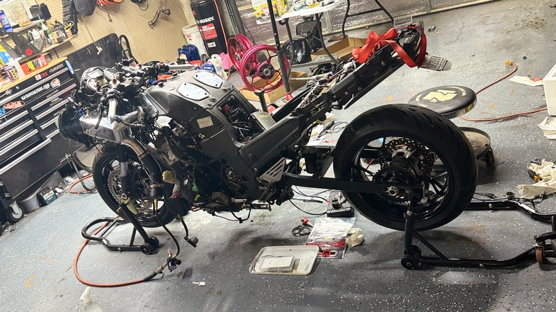

June 22nd, 2025
Ignore filthy garage.
Ceramic Bearing Wheels are on. Looks good. Looks like a bike again. I am working on brake pad spreaders for the front brakes.
Gotta do the chain and boost reference lines still. I pressure tested the airbox and it held a lot of pressure. I added some epoxy to previously identified leaking spots and risk areas and it is leak free.
New Lockup-compatible clutch cover arrives in a few days. then I do my first start...
A special tool for opening the brake pads so the rotor fits between them? Sounds nifty. I always just twisted a wooden shim in there and they open up slowly.
We have a guy on here called 1bad who was talking about smoke testing his air box. It had lots of leak points. I'll probably invest in one of those tools someday. Also, whatever thing you're using to produce pressure in the air box. It seems like using both at the same time would be ideal if that's possible.

Nah I've played with those smoke machines and i hate them. They work great maybe 2-3 times then they stop working. Each one costs about $50 and the smoke fluid stinks and won't clean off of anything. I just used this air compressor adapter with a pressure regulator to pressure the airbox and then sprayed soapy water all over every surface. If there is a leak you'll see bubbles blown from the leak spot. Only downside is everything is covered in soapy water residue, but that's far far better than the smoke machines. Just gotta be smart enough to soak the potential leak areas and read a gauge.
The pad spreader is for when the calipers and pads are installed on the bike. Keeps the pads from resting on the rotors any amount until the lever is pulled. Won't add much resistance if any to the lever. I'm thinking it'll work on the rears, but not the front. There isn't a lot of meat to drill holes into the brakes for the springs to sit in.

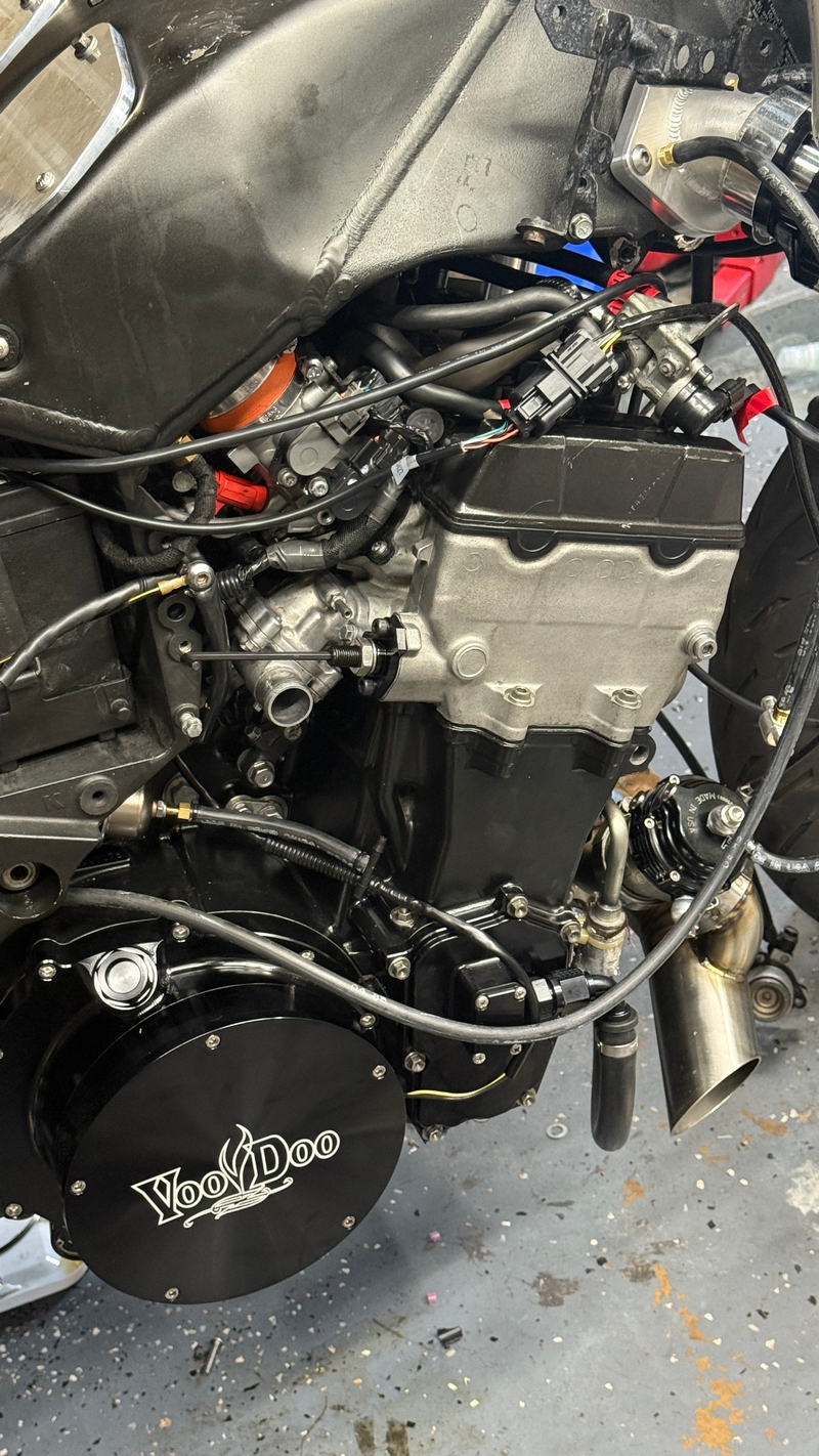

Installed Clutch cover that fits the 2-stage lockup. Added oil. Hit the start button for 10-20 seconds to get oil pumped through engine. Haven't started it yet. Made some funny mechanical noises when holding the starter. I'm hoping it's from the new parts like the mechanical scavenger pump. Gonna stick a camera in the spark plug hole to comfort myself before starting it

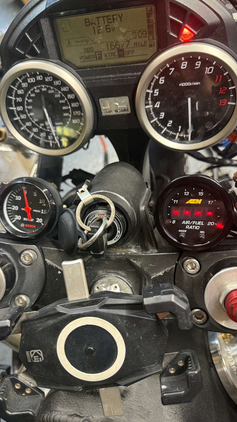

Added AFR Gauge. Fixed boost reference lines and routing. Waiting for some amazon electrical parts to come in so i can finish wiring things correctly. Also waiting on more vacuum hose to run some to the boost gauge. Then I'll start it.

Be careful before starting that baby up! Funny mechanical noises, I hope you were on the phone to Richard right away. I would.
The gauges look incredible! You must have done some research to find those little ones which are ideal for a motorcycle. The best I found were the small, rectangular ones with digital display. I much prefer analog. Nothing wrong with a numeric expression but if you're looking down for a split second, analog is fastest to process mentally. Our buddy Kruz, is an aircraft expert and he said that fighter jets are still using analog gauges.

I am right there with you about analog gauges. hard to find one for AFR that works with the way my mind works. This one has the digital number in the middle as well as a red, yellow, and green ring around the top that shows where in the lean-ideal-rich range the bike is in. Sorta doesn't match the more classic analog boost gauge but oh well. The main dash has a flatscreen on it.

And no calls to Richard. No telling what the noise is to be honest. There's not oil in a lot of areas where there would normally be, just assembly lube. also my balancers are out of balance and so on. I might stick a camera into the cylinders to make sure the cam chain didn't jump a tooth or something. Could be a whole bunch of different things. If I check everything out and nothing looks weird then I'll do the first start.
That works about the same as analog for me. I had a bar graph on my Gen1 for AFR. As long as it's visual instead of numeric, I can see what's basically going on at a glance.

I emailed Richard and he said none of the components should make noise. I'm gonna run gas through the fuel pump and see if maybe the exposed fuel pump lines are what I am hearing. The noise sounds pretty weird. I wish I could record the sound properly and post it here for recommendations.

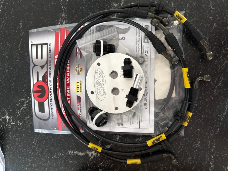

Hose day
(and second fuel plate from RBM cause i screwed up the first)

You got the brake lines I see. Kind of a necessary mod for coolness but like I said, makes no difference in braking performance. It's one I'd always do for the coolness factor though.

I had stainless on the front and back already. I changed swingarm length from +12-14" to +8" to +4", brake line in the back was hilariously long. Front lines had one line down to the right caliper then a short line to the left caliper. I decided to get two long lines to feed straight from the MC. Don't want to deal with big temp differences between calipers as well as potential for water and air accumulation thanks to the high point.
Not to mention that all my lines were different colors. Rear was red, front long was silver, front short was black. Also making the switch to Dot 5.1 while i'm in there

A heads up on the DOT5, it might leak. I've heard of that problem a few times with the stock brakes. Seeps out of the reservoir.
