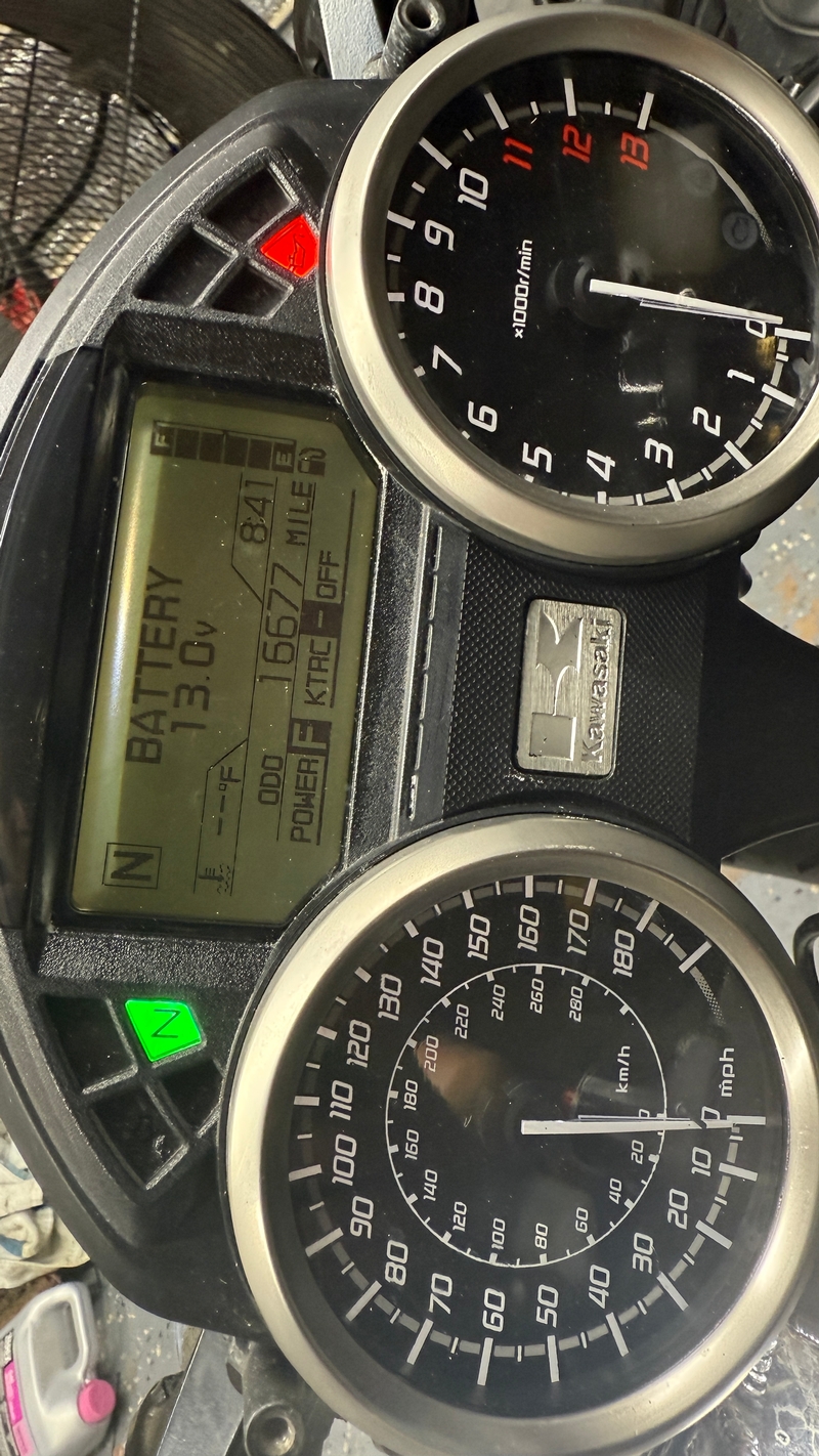

June 30th, 2025
Intercooler lines and pump installed.
Gear indicator issue solved.
Oil pressure light resolved.
Huge complaint about debris inside of the intercooler system.
System uses 1 quart to fill from dry. Filled up intercooler system with Redline Supercool Extreme. Need to add some antifreeze since freezing temp is 32 degrees, unless you winterize. Look into it if running an intercooler. Very nice performance advantage versus normal coolant.
Gear indicator sensor is missing two springs and two brass plugs that rotate based on current gear. These fell out during disassembly, cleaning or assembly and weren't noticed. My buddy's wrecked gen 1 will supply new ones for me.
Oil pressure light stayed on after first start (scared the crap out of me). Reason was because of a used sending unit that came attached to the oil pan I decided to use. I bought a stock pan from Japan because I didnt want to starve the engine with too shallow of a sump. Swapped to my old sending unit and it works great.

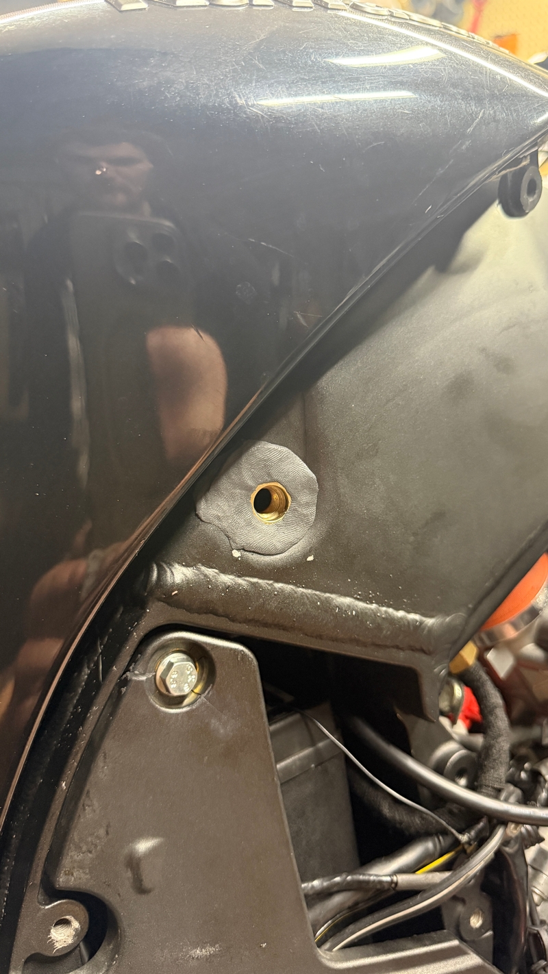

July 2nd, 2025 @ 1am
Riveted and epoxied side airbox holes.
All epoxy I have used on this bike has been JB WELD Tank Weld. Seems to hold pressure great. Spent a few minutes on each side working the epoxy into the lip of the rivet. Size M10-1.5 rivet. Fit in the side holes perfectly. Others have used M8 rivnuts but I didn't like how much room was left around the rivet when I test-fitted it. Too much potential to have the finished product offset and leak severely. M10 rivet slid in without any gap. So I know it likely sealed itself air-tight before epoxy.

Resolved my gear indicator issue as previously explained.
Also sanded and refinished the gauges a little. My gauges has various brake fluid "burns" where the plastic had turned white and was opaque. Nice and clear now.
