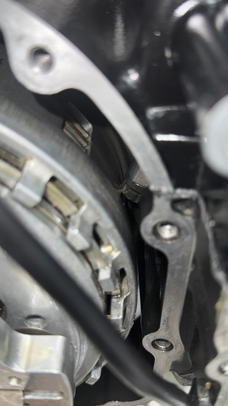

Here is a side by side of the clutch baskets. Stock 2012 and 2012+ MTC Billet
There is quite a lot more meat all around on the MTC. Feels like it weighs about the same. Maybe a couple OZ lighter.

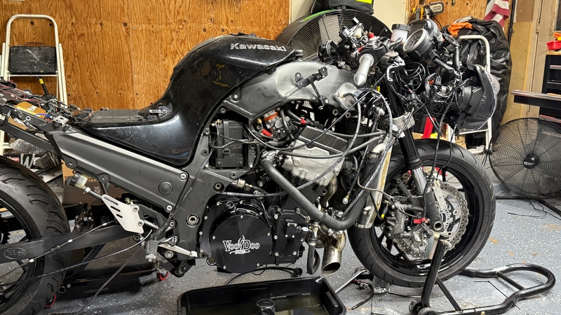

06/29/25 3:23 PM
June 29th, 2025
Installed Idle Air Control system with BOV Spliced into it.
Installed battery covers
About to install New front brake banjo bolt.
This is how you resolve a flashing fuel level reading after using a block off plate on the gas tank.
- Disassemble fuel pump and get resistor cylinder and frame out of pump
- Separate pump frame and cylinder
- Cut to length and strip black wire (ground) and wrap around cylinder a few times
- Solder it all up as ugly as possible as long as it holds
- Cut to length and strip red and yellow wire to solder to cylinder wire
- Solder yellow wires together
- Waterproof (I dipped into rubber cement then wrapped in static cling)
* Last updated by: danmin on 6/30/2025 @ 12:47 PM *

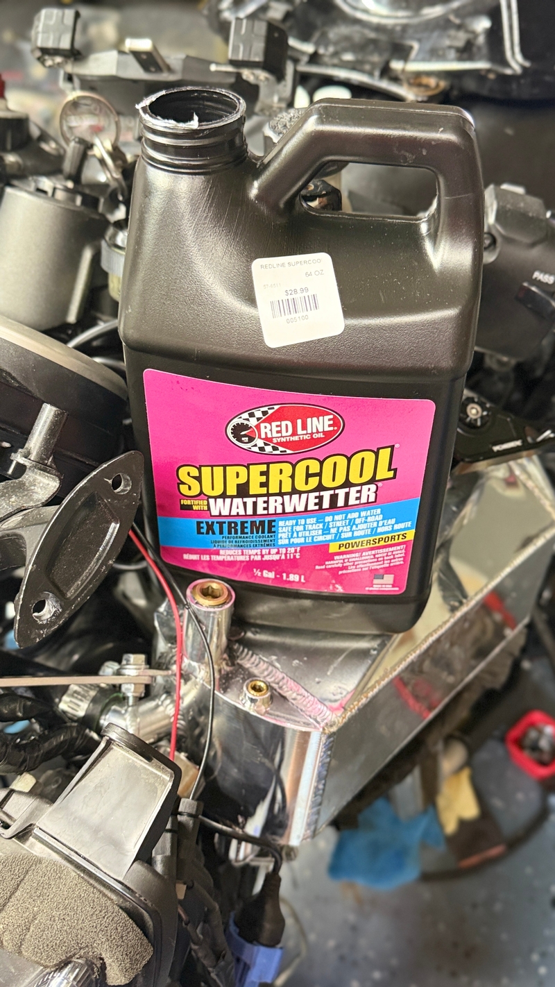

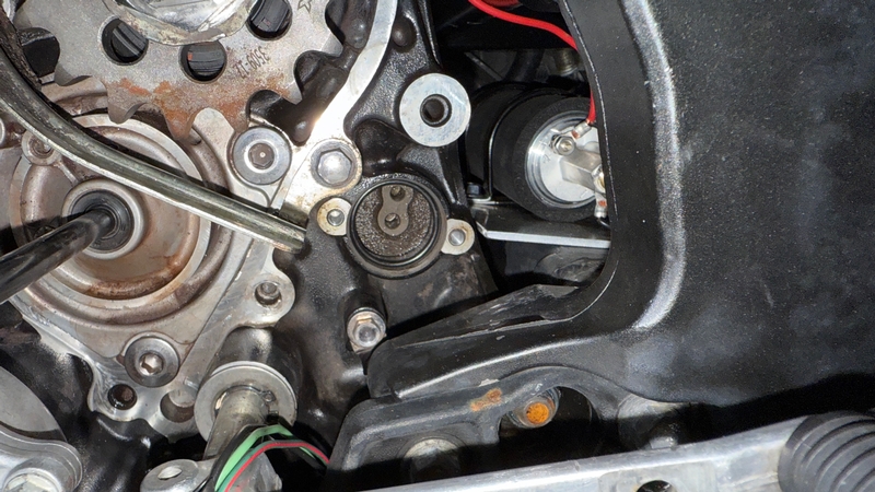

June 30th, 2025
Intercooler lines and pump installed.
Gear indicator issue solved.
Oil pressure light resolved.

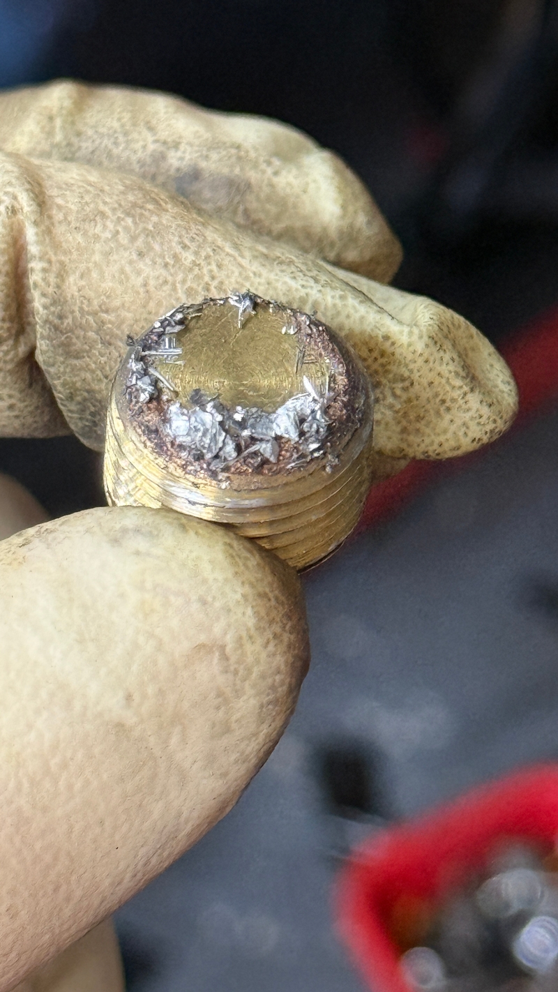

Huge complaint about debris inside of the intercooler system.
System uses 1 quart to fill from dry. Filled up intercooler system with Redline Supercool Extreme. Need to add some antifreeze since freezing temp is 32 degrees, unless you winterize. Look into it if running an intercooler. Very nice performance advantage versus normal coolant.
Gear indicator sensor is missing two springs and two brass plugs that rotate based on current gear. These fell out during disassembly, cleaning or assembly and weren't noticed. My buddy's wrecked gen 1 will supply new ones for me.
Oil pressure light stayed on after first start (scared the crap out of me). Reason was because of a used sending unit that came attached to the oil pan I decided to use. I bought a stock pan from Japan because I didnt want to starve the engine with too shallow of a sump. Swapped to my old sending unit and it works great.
* Last updated by: danmin on 6/30/2025 @ 12:43 PM *

06/30/25 9:18 PM
June 30th, 2025
So far everything is looking good. No leaks. Sounds pretty crazy. Once the turbo warmed up the spooling noise never ends. The neighbors could hear the whistle. Fueling is pretty funky. Doesn't like to idle unless you hold the throttle a little bit when cold. After it ran for 30 seconds like that it would run fine with no throttle input. One it got hot the AFRs went into the 20's. Maybe the sensor isn't calibrated right. Maybe there was an air bubble. Not sure. Gonna let the tuner take a look. Kinda weird.
-Cooling system filled and air bubbles cycled.
-Chain installed.
-Flushed and bled front brakes.
-Flushed and bled clutch line.
-Installed Coremoto Clutch line.
-Installed boost controller.
-Adjusted rear wheel length (130 chain links wasn't enough).
-Installed side brace.
-Coolant tank installed.
-Front sprocket torqued down with titanium nut.
To Do List:
-Fairings
-Install missing wastegate bolt
-Heat cycle the bike a handful of times
-Dyno
-Adjust Balancers
-Ride
* Last updated by: danmin on 6/30/2025 @ 9:31 PM *

As for the shavings in the intercooler, WTAF? Where were the shavings in the intercooler? ...I mean did it go into the air box of your bike?

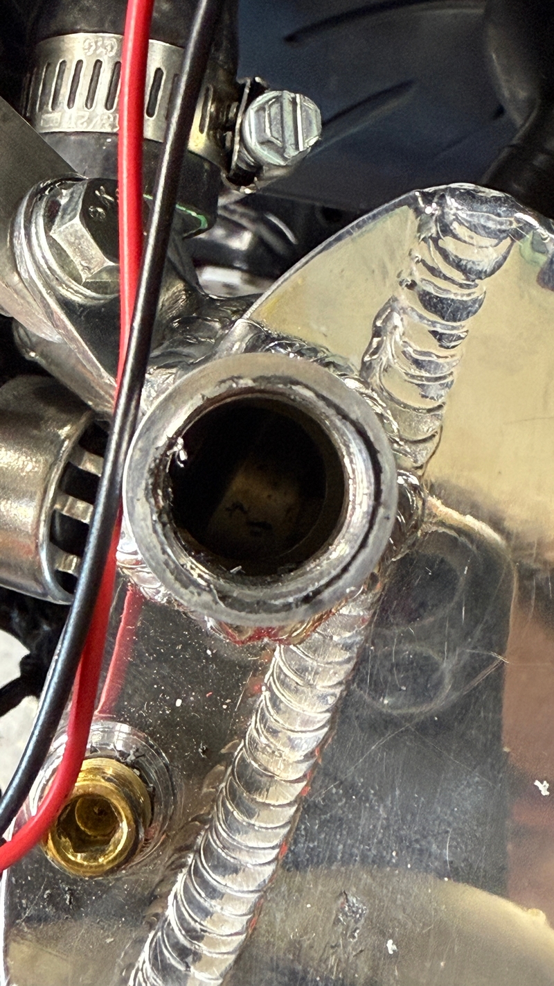

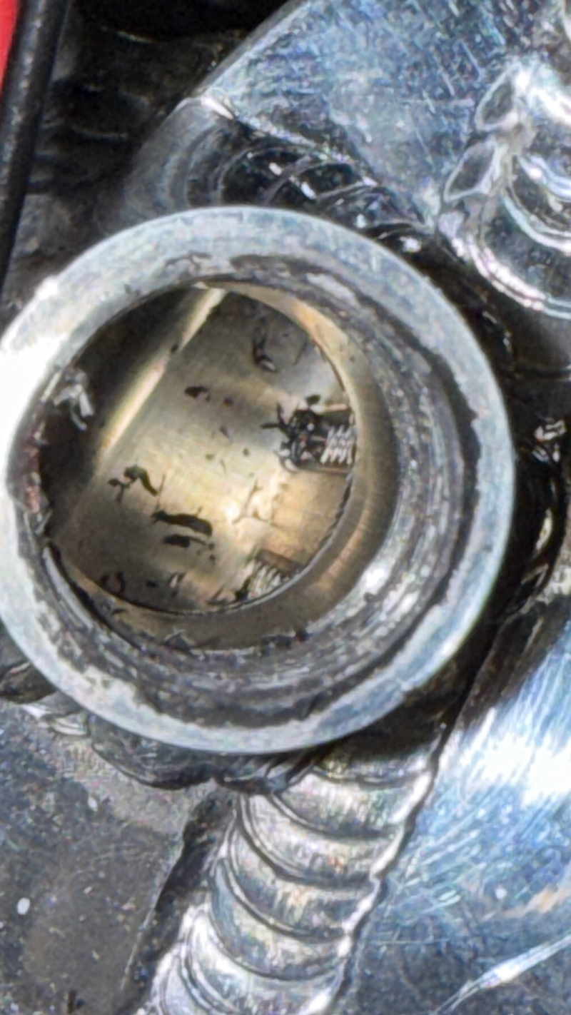

Turbo sounds great. Pretty unreal sounding machine.
I checked the intake track of the intercooler for metal when I received it. It had a few flakes in it. I cleaned it. Same with the turbo. Couple chunks. Little balls of metal the size of a flea, welding spatter. As well as small flake from cutting/grinding of some sort. Cleaned that out because no way was I gonna let that get sucked into the engine.
Metal flakes pictured appear to be from the tapping of the intercooler for the cooling system inlet. These are in the cooling system. I am looking into adding a coolant filter. I expected a little metal to clean out of stuff since it is a fab shop and they churn these kits out daily. I was hoping for a little cleaner of an experience given that I shelled out 12-13 grand or whatever it was for the kit and wasn't exactly met with an inviting checkout experience either.
Guess thats the trade-off for stuff fitting right up and bolting together right. Cant complain about too much besides that stuff. I am going to rework some of the instructions to break up the work a little better. IE- section 1: front of bike. section 2: routing hoses, so on, so on
