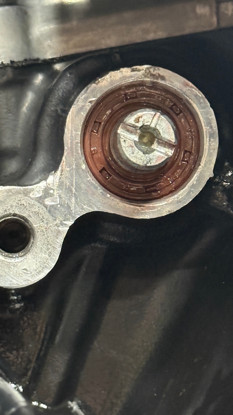

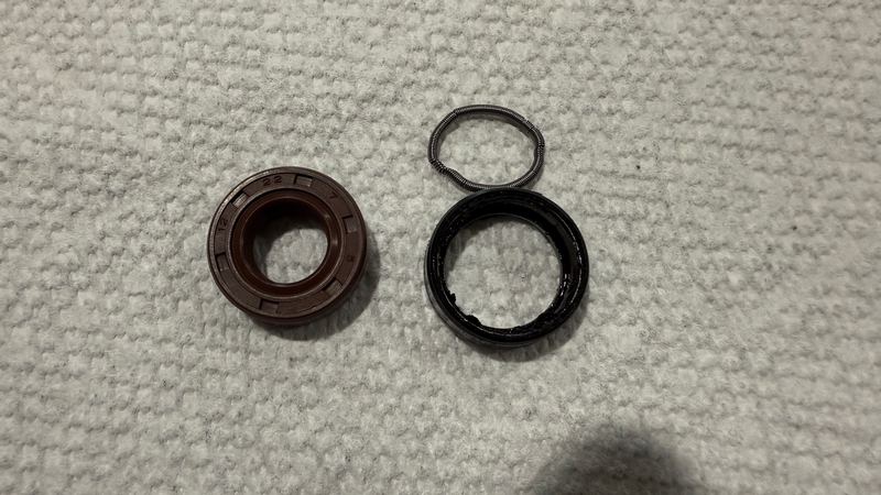

-Replaced Rear Balancer Shaft seal with Amazon one. Came a day early somehow. You'll never believe the side by side photo. I didn't realize it was missing that much 'meat'

Got the bike running. Looks to be running pretty lean during warmup, but maybe that's just the sensor not reading right while it gets up to temp.
I washed the bike after installing the part. Didn't see any leaks. I checked real close to the seal and it just looked like it had the assembly lube on it, from the install of the seal. No oil weeps.

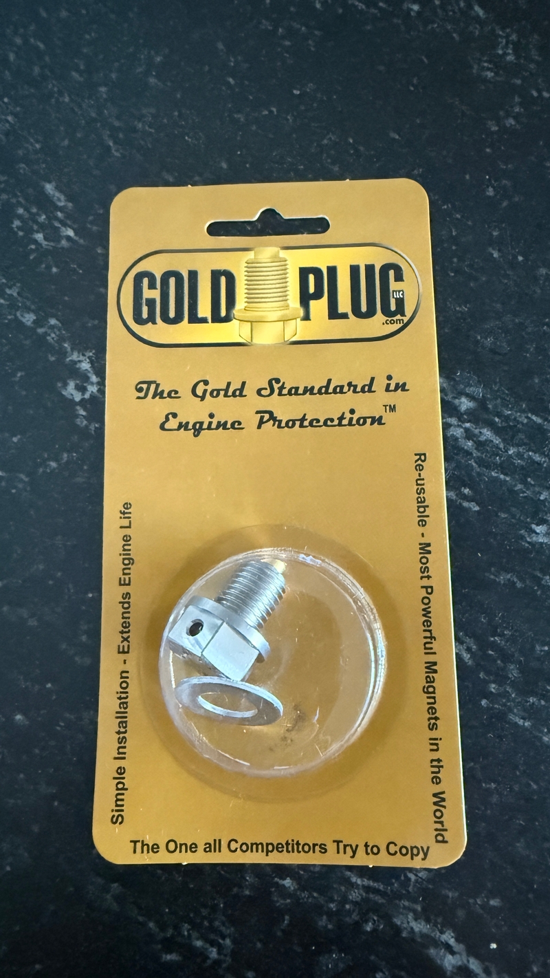

Gold plug arrived. Installed it. Which meant I got to drain a little oil out when I switched it. I had the bike sitting on it's rear stand only. Any chunks or flakes, in theory, settled in the pan closest to the drain plug. So I got to evacuate those. I am still dealing with the 'glitter' of coating everything in Moly. Also looked like a few minor slivers of alum from the clutch basket getting torn up were still getting washed out of the nooks and crannies of the engine. Unsettling. But not much that can be done about that besides oil flushes. Engine is on it's third set of oil since rebuild. It's getting better each time. I think I'll swap the filter and oil out once I'm back from dyno day. I've got one K&N filter left before I start grabbing NAPA Gold filters. Maybe I can set up a business account and fet a deal.
The magnet in this sucker is pretty strong. It'll definitely pick up anything magnetic in the oil. I wasn't worried about much of that, but it is still nice to have.

Gold plug arrived.
I have that. Yes, the magnet is superb and I see they now include a safety wire hole! Being obsessed with weight reduction, I switched to an aluminum plug and it had a much smaller magnet which still seemed to work. I'm sure the Gold Plug was more effective at picking stuff up though. I banged the gearbox really hard a couple times using a quickshifter. The transmission was never the same after that. It worked fine using the clutch but it was unreliable with the quickshifter (kicked back to second gear and almost looped me). The Gold Plug picked up chunks over three oil changes in about a years time. I still might be getting a little chunk now and then if the bike was still running. A foot quickshifter is cool for sport riding but on a turbo bike, I'd have an electric shifter or air. Romans used that along with some special electronic and he said it worked flawlessly. He even had it set up to shift automatically at a certain rpm so there would be no chance of human error.

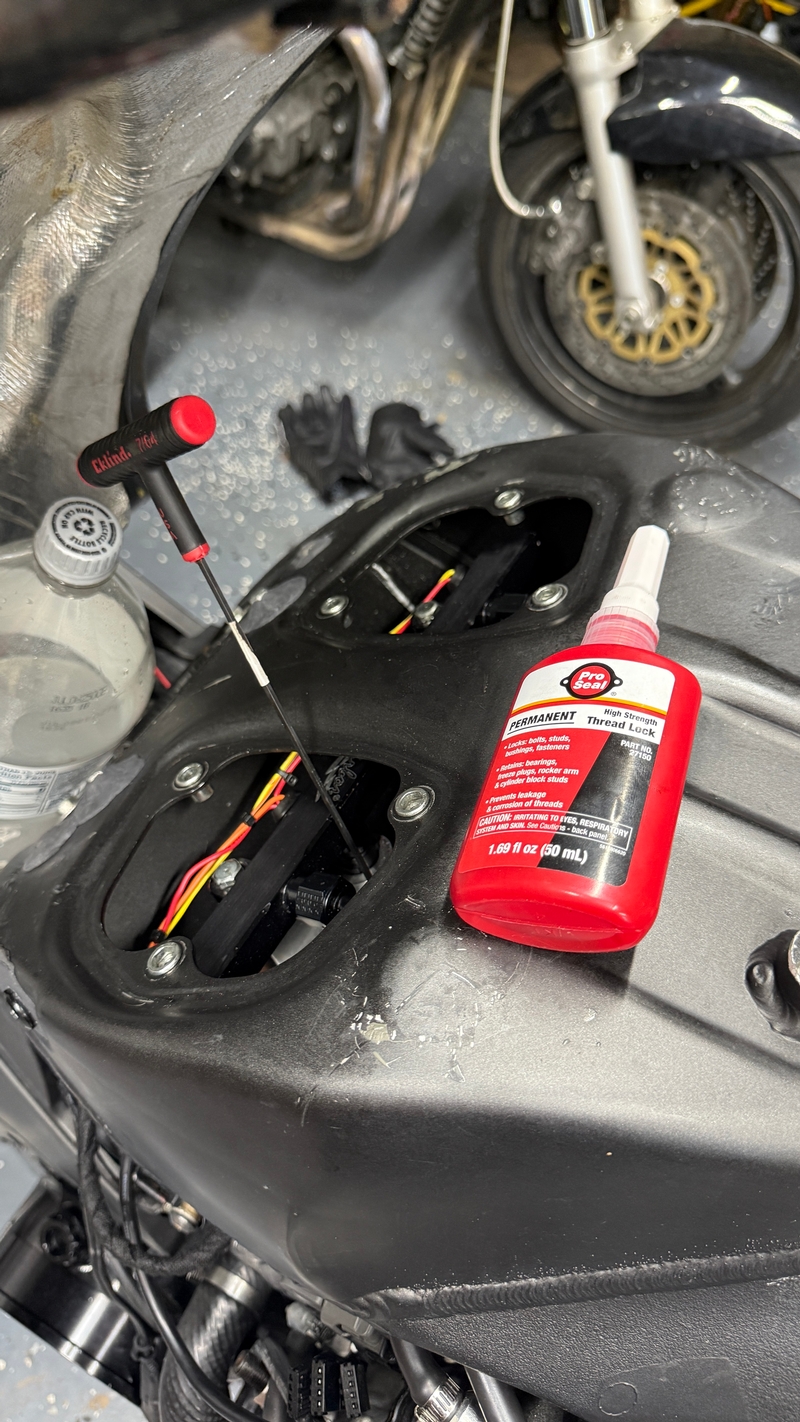

I bought this neat little super long allen key to check the air duct plate bolts. All were right except 3 seemed to have loosened a little. The threads on those ones didn't appear to have a ton of loctite on them. My guess is the loctite was rubbed off while handling it on install. I just poured the loctite onto the tool after unscrewing the bolt 80%. The loctite would work its way down the bolt head and into the threads. only needed a little cleanup afterwards. Although with how small the hex size is- this tool didn't have very high twist resistance. Might revisit this with an alternate tool for more power. This certainly did the job at least. The 3 loose guys are no swimming in proseal red.
