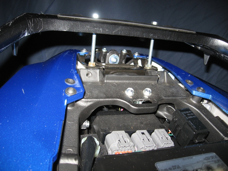

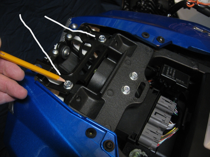

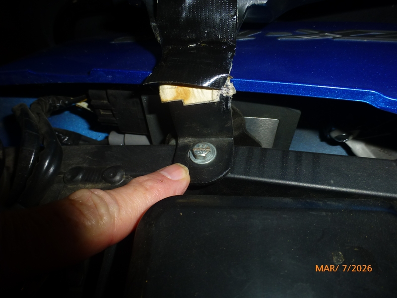

I hate the facebook page of zx14, zx14r, zx1441. No one has anyway to search for old threads for answers. I post pages from here thinking they will look for more answers, but never do. I do everything on a laptop-no smartphone. My pic load quick. All people do is ask a question? On our website owners have been posting about side and top luggage for over 15 years.
Finding SW-motech racks seem impossible now. I think they are made in Poland.

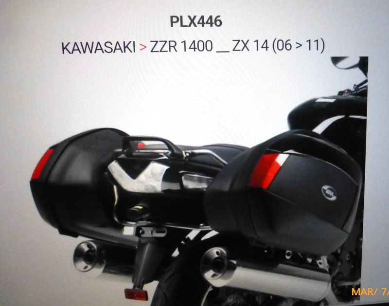

eBay lists Givi racks PLX446 for V35 Givi cases. They mount differently in the rear. Made for the ZX1400 European model with the passenger grab handle showing.
The SW-Motech side rack bolts to solid locations. A piece of plastic had to be cut near the rear seat area. My kit came with a "template" and the tail fairing covers your cut.
My Suz SV650 luggage rack carries most of the load at the rear and Kawasaki already gave me threaded holes to mount it. At the front I used 5mm bolts through the frame with nylon nuts. I just checked after 12 yrs everything is still secure.
I just watched youtube dragtimes channel-(Daytona Bike week 2026) that Kawasaki will be bringing back the ZX14r. They want to clear inventory. Maybe they will add throttle by wire and give us cruise control?
I have over 300 photos under my stored cabinet. I wonder how to delete some of them? Probably cannot. I was reading that everything I post on facebook belongs to them and it stays open forever to my friends. I have an aunt who died in 2019 and people wish her "Happy heavenly Birthday" each year. Before I die I will be posting my 28yr old mug and my favorite background photo. On facebook you live forever.
First you locate and secure the rear mounting bolts, then you do the front. I have many pics you want them posted.

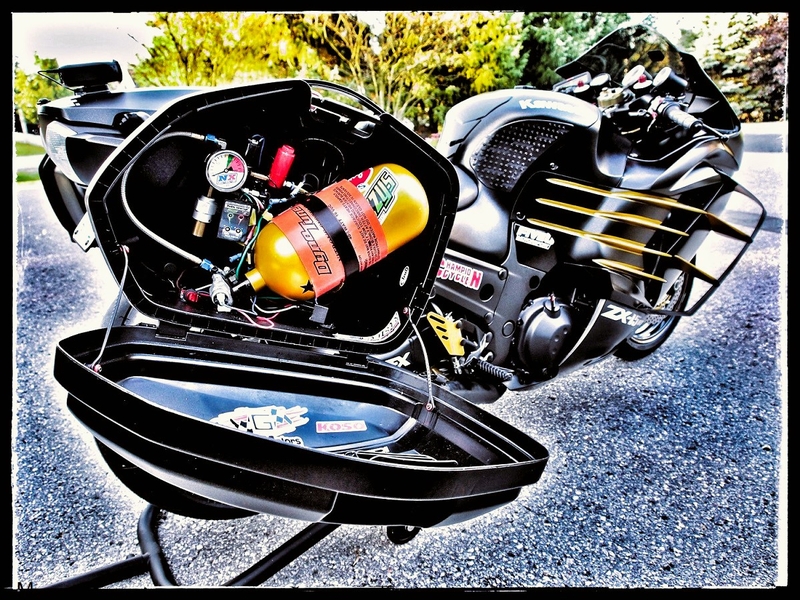

I need to look into the Nitrous issue, I know it's a big boost, but
nothing about how much boost, engine stress if any, how it's interfaced etc....
Follow Cliff Randall's ZX1501 325HP NOS Project.
https://zx14ninjaforum.com/messages.cfm?threadid=96163B92-D909-0DAA-DA3B4607F8A1CE99&page=1&searchTerm=Cliff%20Randall#1
* Last updated by: doubleD on 3/7/2026 @ 1:53 PM *

Amazing looking Nitros bike.
Is that your mother in law wrapped up on the back of that blue bike?
Is that Honda 175 circa 1970 something?

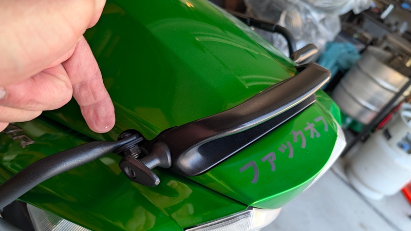

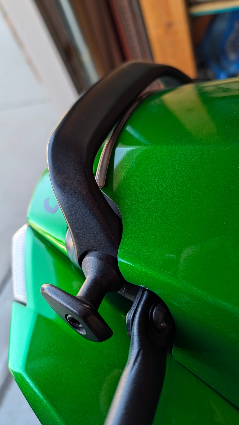

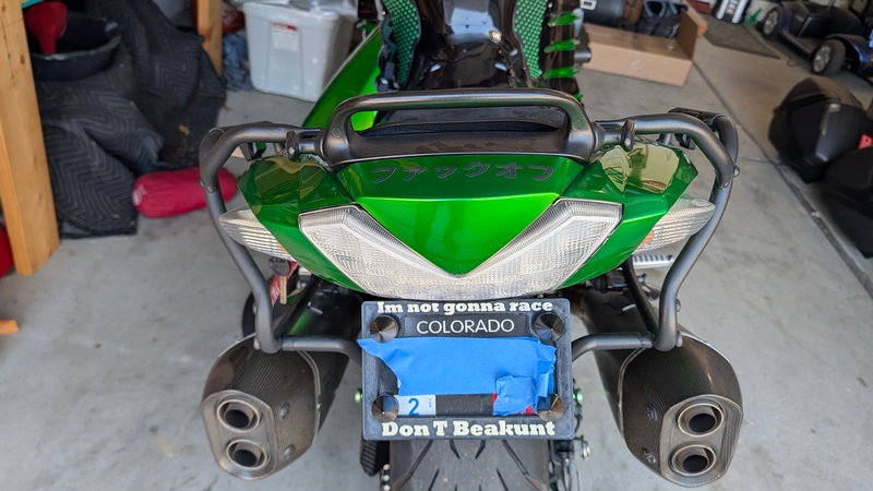

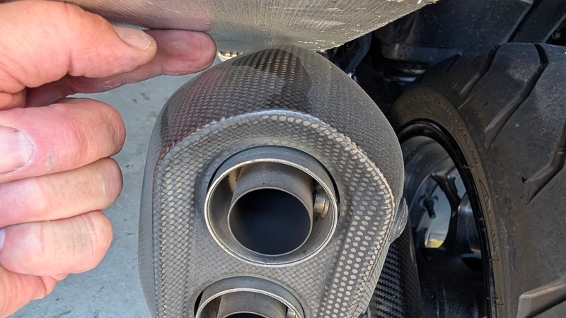

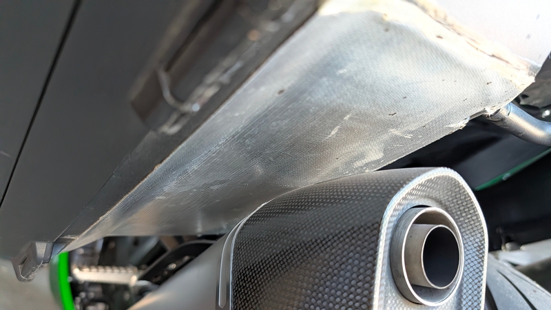

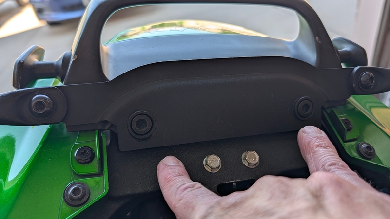

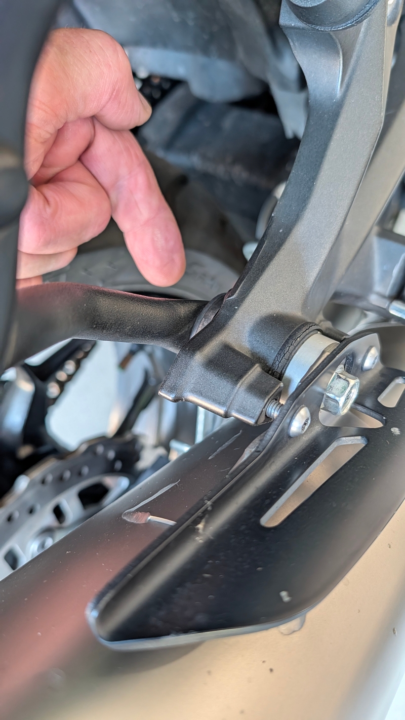

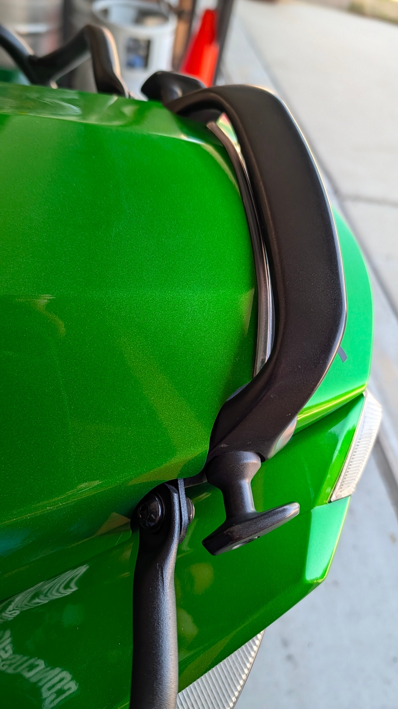

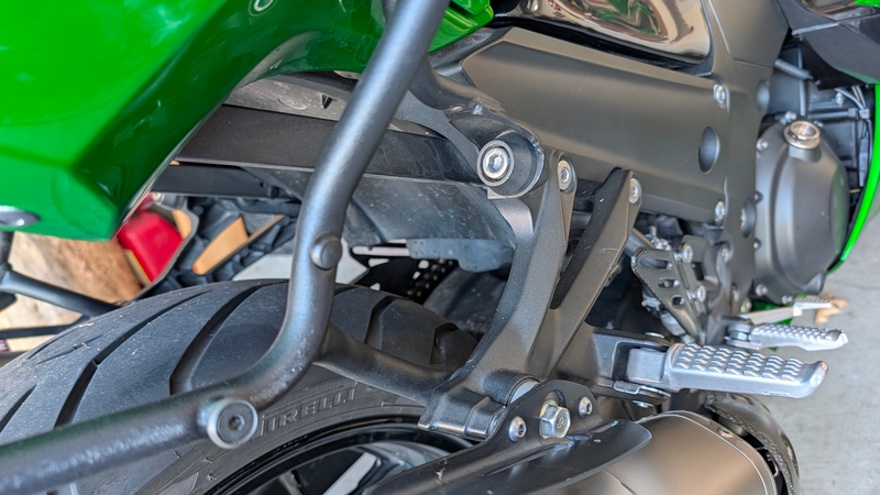

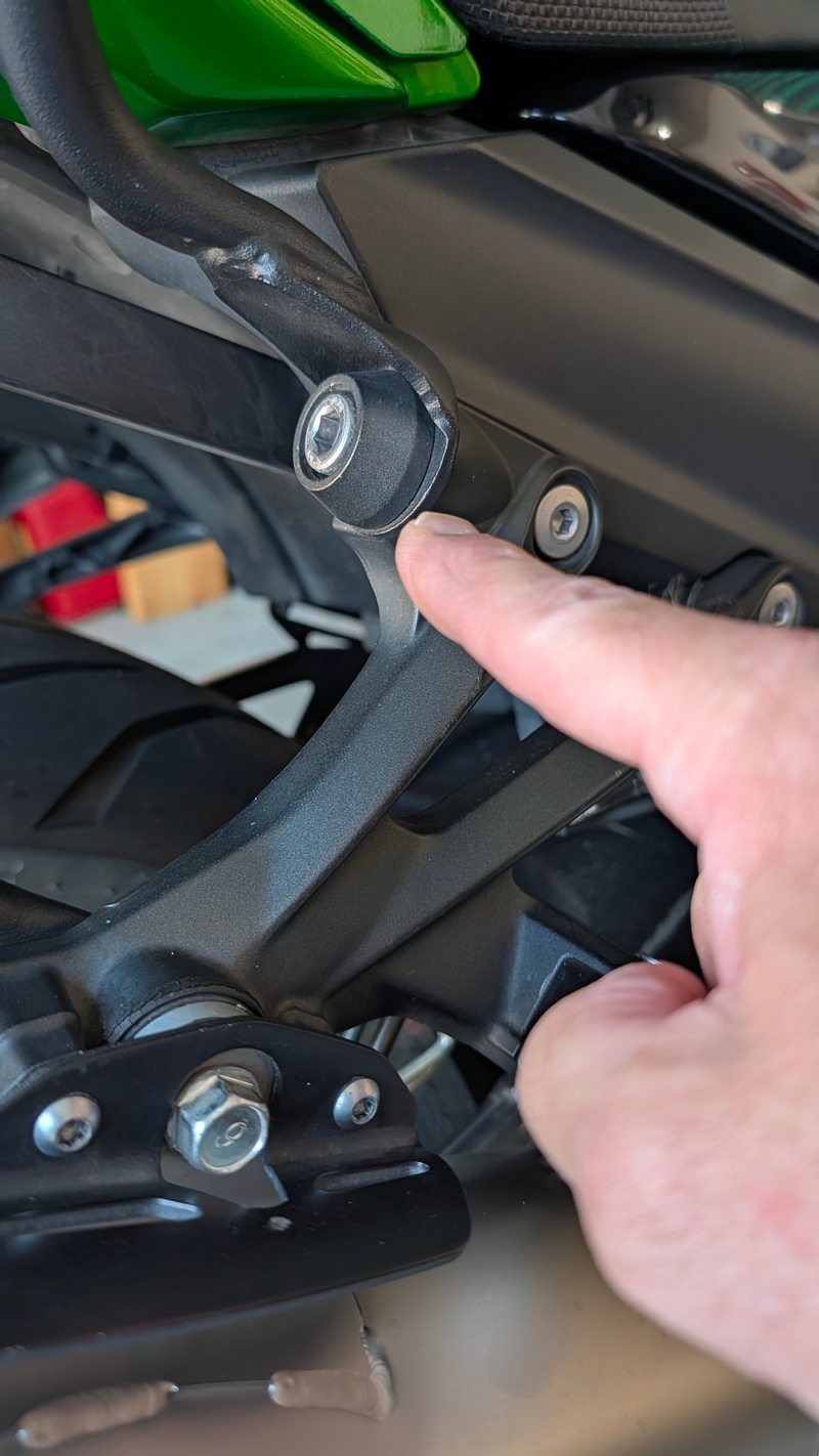

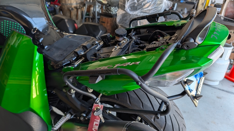

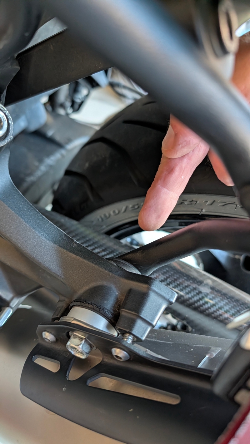

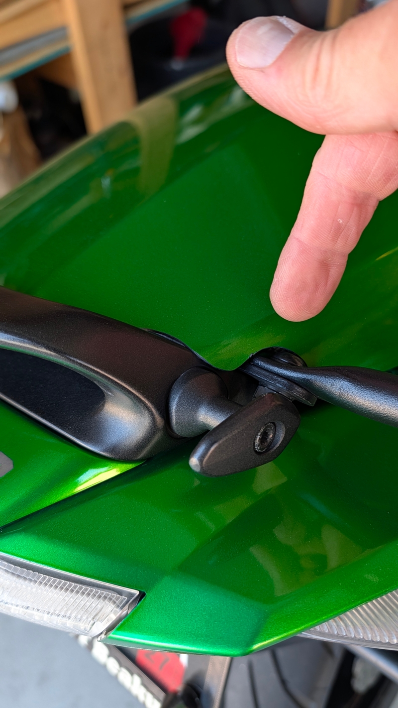

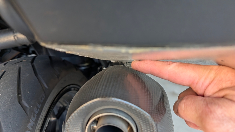

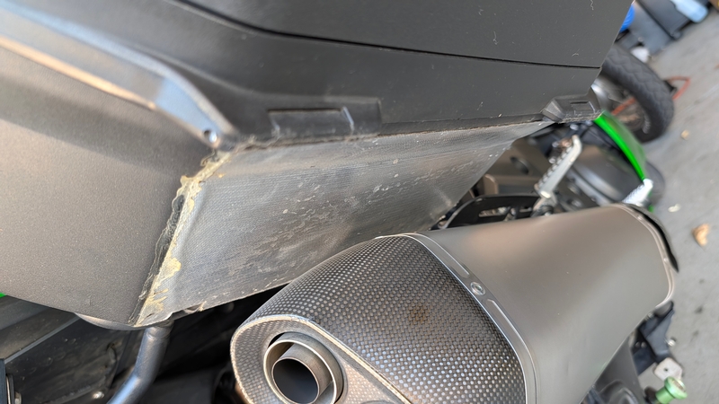

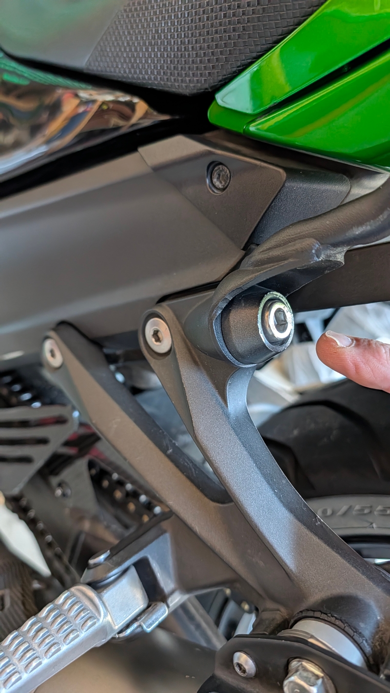

Starboard side: passenger peg/muffler hanger bracket mounted
Port side: passenger peg/muffler hanger bracket mounted
Rear passenger grab handle mount
Rear seat cowling mod required
Bag and muffler clearance and heatshield
I hope this helps.
* Last updated by: DTTyson on 7/25/2026 @ 12:15 PM *
