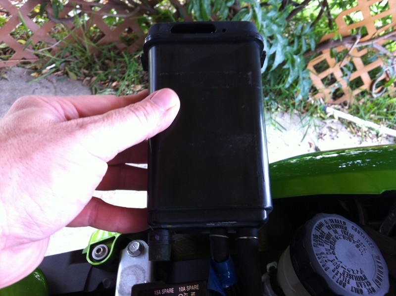

I have a box under the seat of my '09 that I do not see in any other pictures, nor can I find it in the service manual. I'm trying to do the under seat install of the PC5, and this is right in the way:
What is it and what do I do with it?

Evaporative emissions canister... Your bike is a Cali bike... If you live in Cali, it is illegal to remove it... But...
Cali tank on no-Cali bike?
* Last updated by: DogoZX on 7/4/2012 @ 1:12 PM *

Yup part of the emissions equipment. I have this same box on mine (2010) and mine IS NOT a Cali bike - it was bought in Texas...

May not have bought your bike in Cali, BW... but if you have that canister, you have a Cali model.
If you wanna remove it, HERE'S a thread.

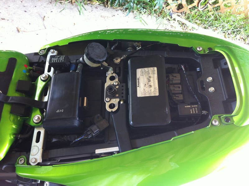

Thanks Dogo, very helpful! So, I'm pretty bad at deciphering Hub-speak... What did you end up doing with the red and blue lines from the tank? Should I remove the entire system and do that?
That thread on bikeland says:
Black w/ Blue strip ........ leave open to vent under seat.
Black w/ Green strip ...... remove completely - this hose runs up to
the #3 intake port. Remove hose and install a vacuum cap.
Is that correct? I can just remove the box and take those steps with the lines, leaving the separator and other lines in place? I like the idea of having the emissions thing on there, but I really want that trunk space for my PCV and Speedohealer, and the Autotuner I'm probably going to be getting before too long.

I ran lines from both nipples down into the belly. They're the red ones in the pic:
I coulda just capped the red nipple... But what if the tank somehow built enough pressure to blow off the cap? Gas on hot motor? No thanks! I just have to be sure not to overfill my tank. Not an issue on a track only bike that I try to run the minumum amount of gas necessary in. Proper fix would be to braze the red one... That's what was done on my CBR.
^^^ Sounds right to me. ^^^
